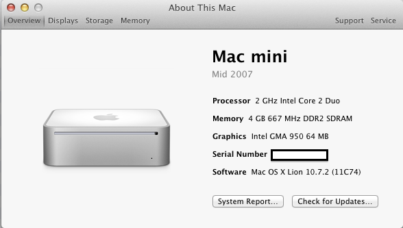

I have upgraded my Mid 2007 Mac Mini to 4Gb memory system recognises all 4Gb, although 64Mb is used for the graphics.
I use an OCZ technologies Vertex 2, which gives the system a noticeable improvement in response/performance etc. for a Mac Mini.
Also run the OS X Lion (64bit)
See included screen shots

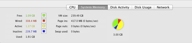

AndrewHF1: in other posts I've read that the system recognizes the 4GB, but it cannot use them: only 3GB are usable.

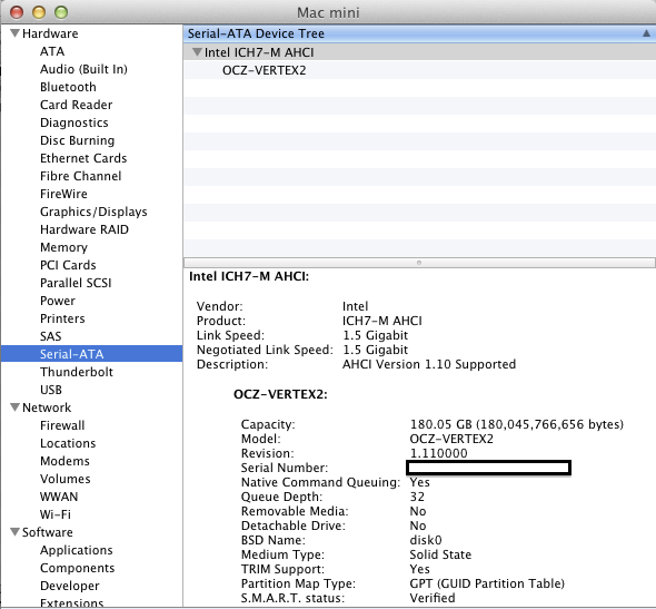

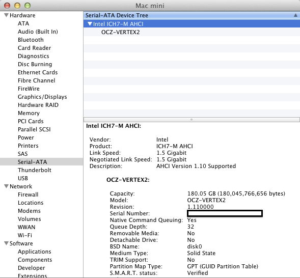

About your SSD, I see that you have TRIM not enabled. Some disks suffer a degradation in performance. See this post, for example. How long have you had it?

Trim enabled in OSX Lion
I have had the SSD just over a year on the MacMini system with no (humanly) noticeable drop in performance over this time. Even though I have had the system mini for a number of years I have never solely used the Mac for all computer needs I need a Windows (don't shot me) for some of my research. So have not had the time to play more (i.e. lift the bonnet/hood and tinker) with OSX etc.
I looked into TRIM Enabler for Lion; Lion only automatically does it for Apple supplied SSD. I used the information at this URL: http://digitaldj.net/2011/07/21/trim-enabler-for-lion/ to successfully enable TRIM for my SSD (see attached)!
You were correct about the memory size of the usable memory, only 3Gb usable (see attached). I'll have to substitute one of the 2Gb SODIMM's with a 1Gb (when I get the time), which is what Apple used to sell one 2Gb and one 1Gb together as an upgrade. I just had two 2Gb DDR2 SODIMM spare after a Win PC upgrade so used them, they worked.
