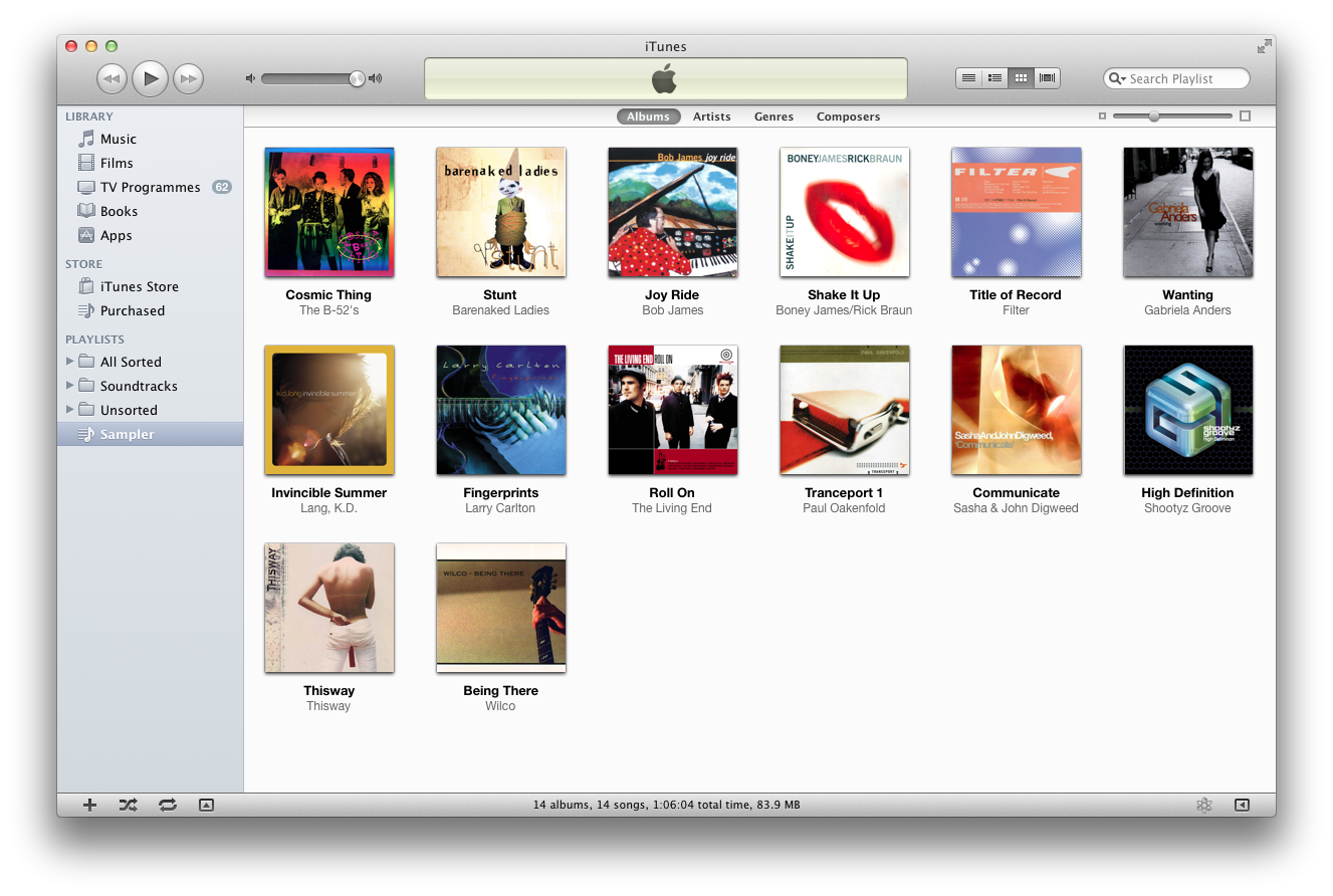

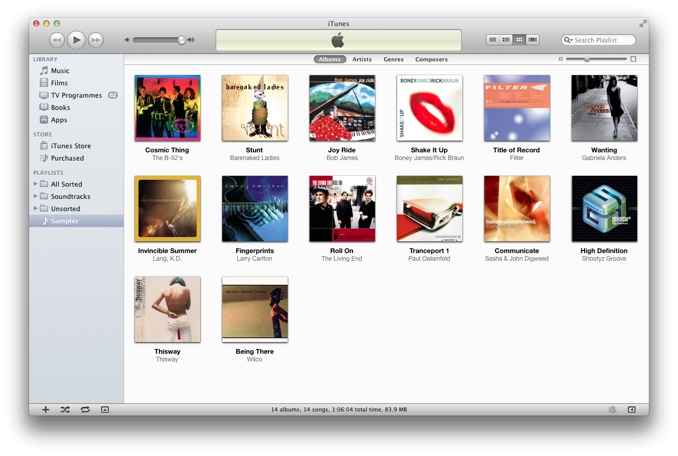

I have the original restore disks, yep. I used them to make the system factory fresh, it's funny to use Mac OS X 10.1 and iTunes 1 again after all these years 🙂 There were even 14 free songs (this was before pre-iTunes-Store) I'd forgotten all about, check out the attached image!
So I may leave it like that, not even update to 10.1.5, but may install 10.2, 10.3 or 10.4, depending on which one works best with WAP and the newly-free Adobe CS2.
