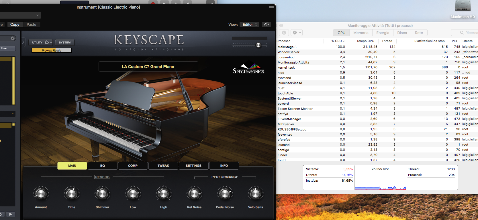

Not sure if VST is I/O limiting. If there is a significant slow down in your workflow because you have to wait for loading to complete. Then use a PCIe SSD may able to help. However, you really have to find out if the waiting is due to I/O. Just because waiting for loading doesn't mean it's I/O limiting. Especially if you see there is a 100% CPU usage (single thread, not the whole CPU stress to 100%) like this
Then this is a sign of CPU (single thread) limiting, but not I/O limiting. In this case, upgrade the SSD won't help.

You have to check if the CPU is single thread limiting. Total CPU usage at normal (or even low) level doesn't mean much in general.
Also, if you can make a small size sample (just few GB), then you can create a RAM drive, put the sample at there. Then you will know if storage speed make the difference.

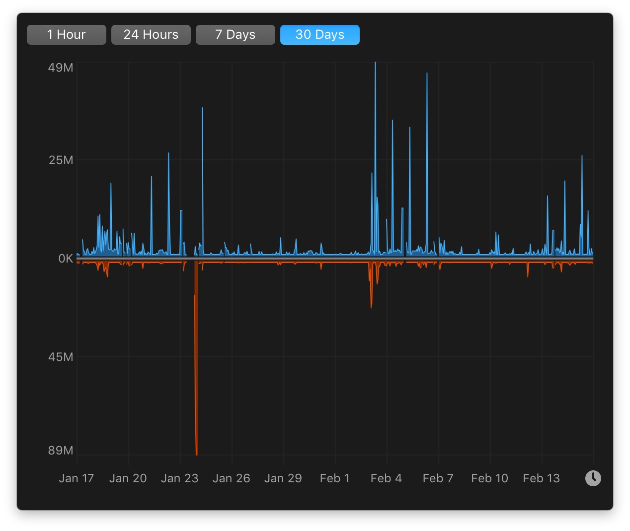

The most cost effective way to boot macOS from SSD on the cMP is SATA SSD without any PCIe card. And this give you virtually the same performance as any other solution.
I don't know how you use your Mac. But this is what my Mac did in the last 30 days. 99% of the time don't even need 25MB/s.

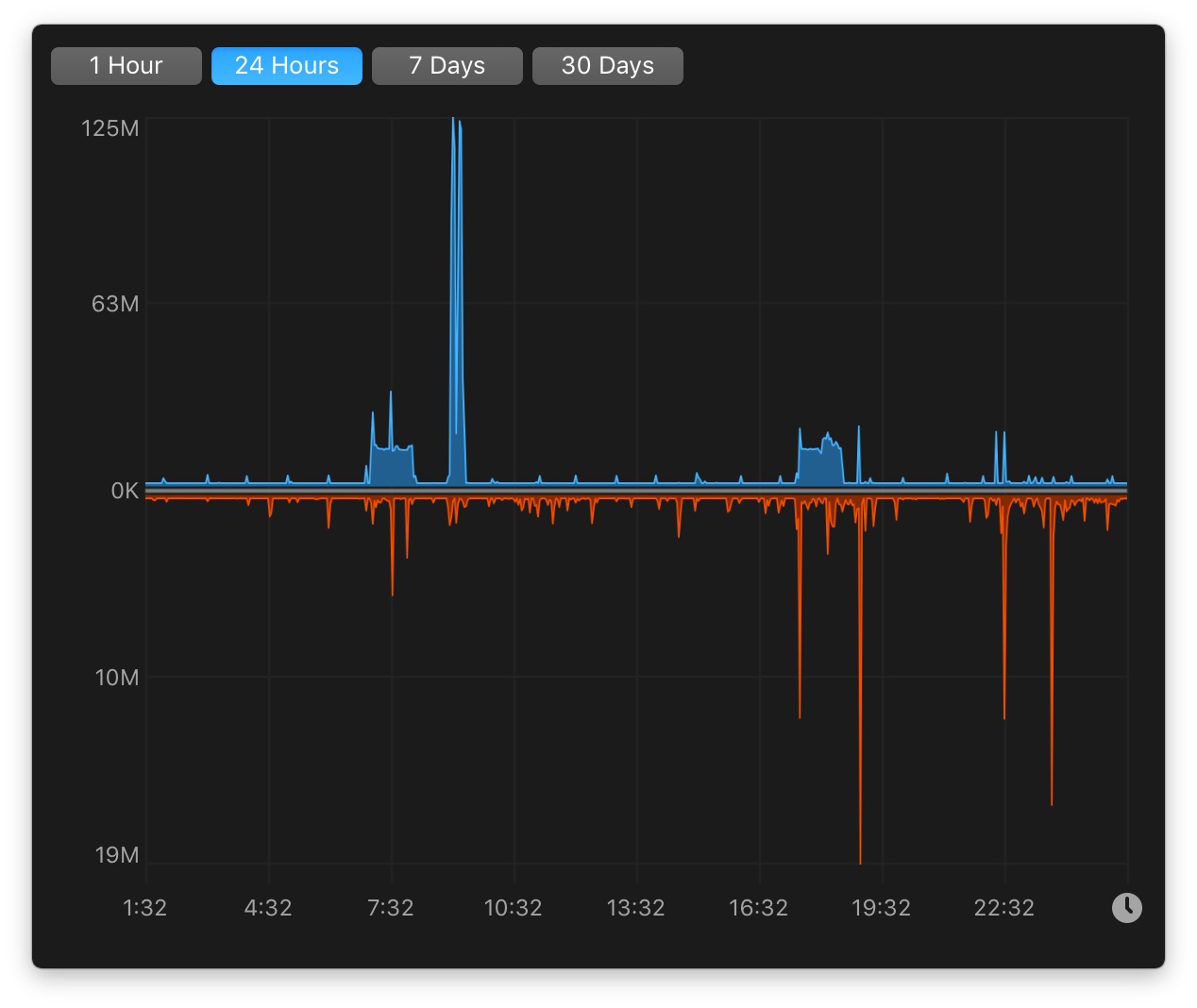

And in the last 24 hours, the highest loading is about 125MB/s. This is not the real peak, because there may be a split second that the SSD really working at above 300MB/s, but just can't be displayed in the chart. And that's why I say a faster SSD may save you few seconds per day (for normal OS operation).

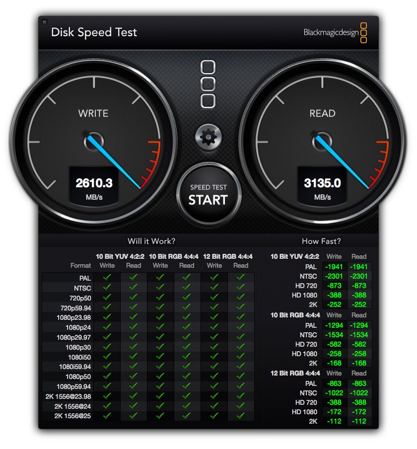

That's correct. And this is why Blackmagic disk speed test shows you all the video format. This speed is relevant for video editing, but not OS operation.

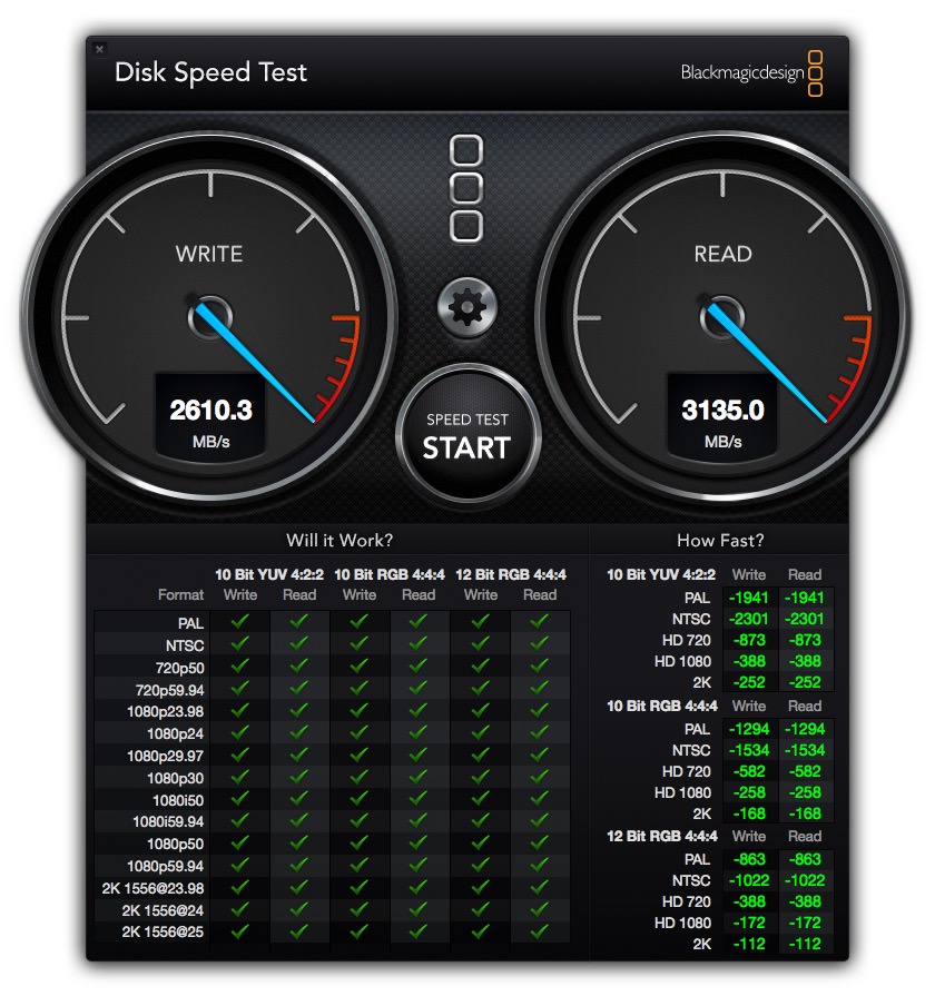

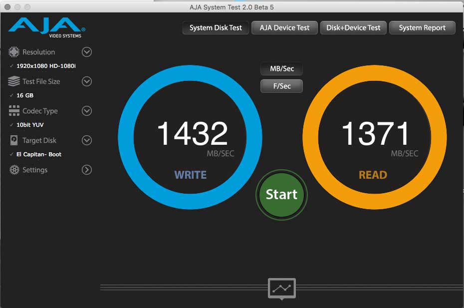

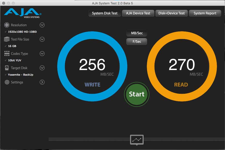

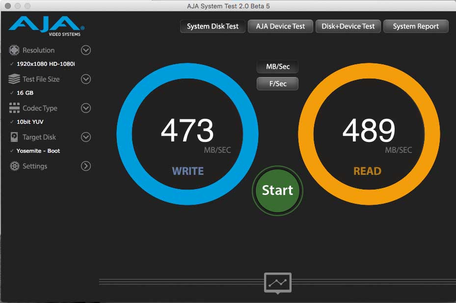

I have 5 SSDs in my system. 1 is a Samsung SM951 mounted in an AngelBird enclosure, 2 are mounted on a a Velocity x2 Duo the other 2 are mounted in the the HDD bay using VelociRaptor mounting sleds. The sleds are cheap, very strong and have cooling fins. Like this:
https://www.ebay.com/itm/Western-Di...790876&hash=item362bf60404:g:kdIAAOSwSFJahKcG
I remove the mounted HDD and replace it with an SSD.

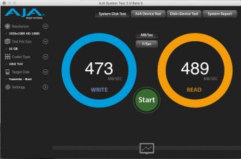

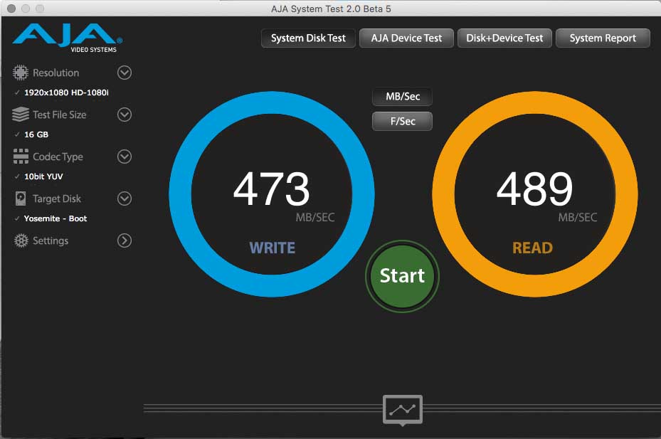

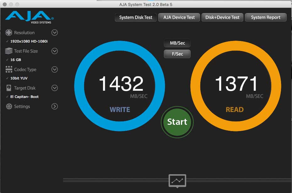

As far as speed goes benchmarks show the following:
The first is the SM951, the second is an 840 Pro on the Velocity Card, the third is an 840 Evo in an HDD tray.
Lou

this is the test i made. do i have single thread limiting?
