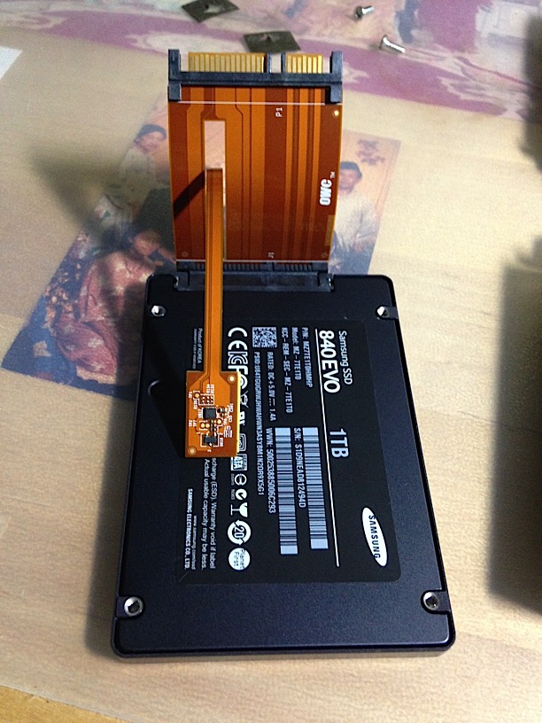

http://eshop.macsales.com/item/OWC/DIDIMACHDD11/
I remember talk a few years ago of pinning out the fan controller if you were using an SSD so maybe there's a budget solution but at least this one will work.

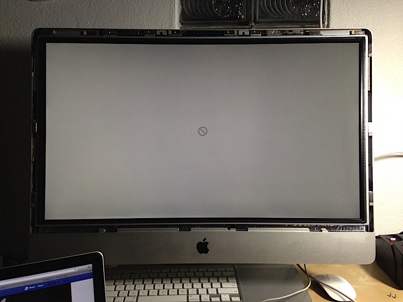

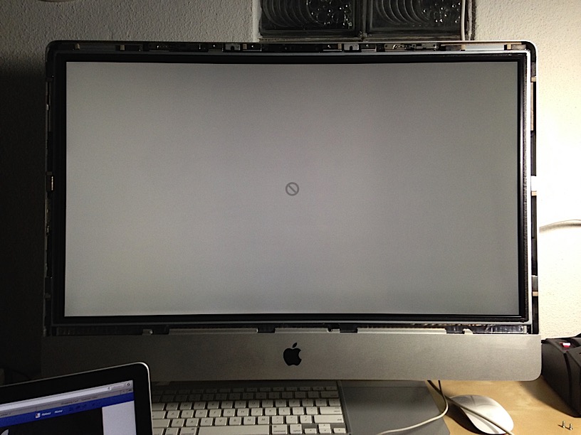

That OWC In-line Digital Thermal Sensor WILL NOT work on SSD drives. Trust me. I have bought it.
OWC In-line Digital Thermal Sensor doesn't work
By "will not work" do you mean doesn't physically fit into the SSD connector or the temperature sensor doesn't properly function ?
Did OWC help any with the part not working ? It's not a cheap connector.
The cable only works on normal hard drives. It does not recognise SSD drives as I have test it on both of my SSDs and the only thing I get is the white screen of death.
