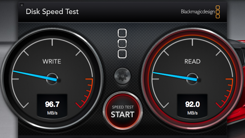

Does this look normal for a Mid-2009 MBP. HDD is a 7200rpm 500gb, SSD is a Samsung 840 250GB...
SSD:
HDD:
