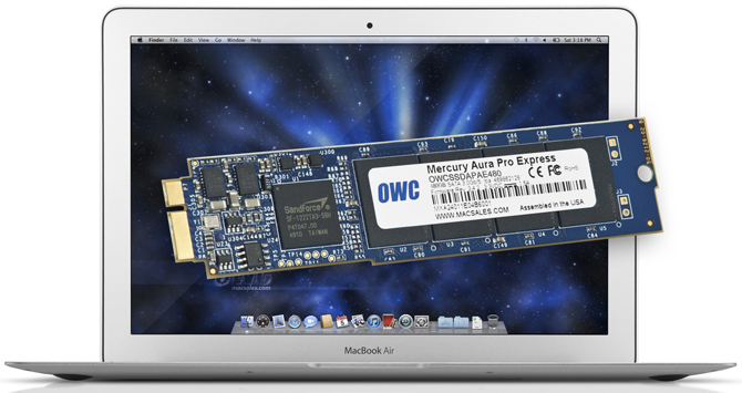

Hello! Can anyone give an answer, is there a way, to install SSD-Drive in addition to my default HDD-Drive, without removing an Optical Drive? (iMac 21.5" Mid 2011).
I can find only hdd-replacement or optical drive replacement tutors. I'm understand, that 21.5" iMacs haven't enough place to simply add 2.5" SSD, but, maybe I can definitely use SSD without body, like SSD-Drive that installed in MacBooks?

I believe owc has turnkey and self install options to add another ssd drive, while keeping the optical. They have a video of the process on the web site.
http://eshop.macsales.com/item/OWC/DIYIM21SSD11/
Edit: Looking at the video, they are adding a 2.5 ssd drive while keeping the optical drive, should be enough room. Of course, I think the install looks advanced enough I would seriously consider the turnkey program they offer.
