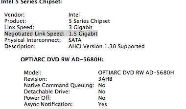

I have a late 2009 iMac with a 2 TB drive, 16MB ram, my machine is getting a bit slow, exspecially using Aperture.
I would like to buy the http://eshop.macsales.com/item/OWC/DDIMSSD480/ for my mac.
In this regard, I have some questions for you smart people on this forum.
Having checked my machine system imformation, it looks like the the shipset for the dvd drive only suports
( I want to keep my 2TB drive & put the ssd in the dvd drive)
Negotiated Link Speed: 1.5 Gigabit
Will there still be a big improvement in speed, is there a way to get the speed up to 3 Gigabit?
also how about the fans on the machine, will they spin out of control?
Hope for some answers 🙂

Talked with a guy at OWC, he assured me that the product would work with 3Gigabit throughput.
The negotiated link speed is the speed that tho HDD currently in there runs at. The link speed is the highest speed that it run. Therefore, putting an SSD will run it at 3Gbps.
One thing to note however, is that some SSD's that are rated for SATA3, when used with a SATA2 connection will run at SATA1. This, I believe, is specific to SandForce based drives such as OWC, Kingston. I would recommend a Crucial M500 for you.

I have a late iMac 2009 (iMac11,1) with an OWC Mercury Electra 3G SSD installed in a data doubler (replacing the superdrive).
Getting
Link Speed: 3 Gigabit
Negotiated Link Speed: 3 Gigabit
It's running now for more than a year without problems. Significant speed improvements.
If I do it again I would install a M500 960GB - prices have come down! (installed that one in my friends iMac - runs like a charm)
Since the late 2009 iMac only runs SATA II - 3GB and not the faster SATA III - 6GB you don't need the newer/faster M550 or MX100. Go for the cheaper M500.
