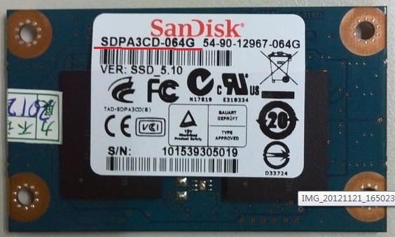

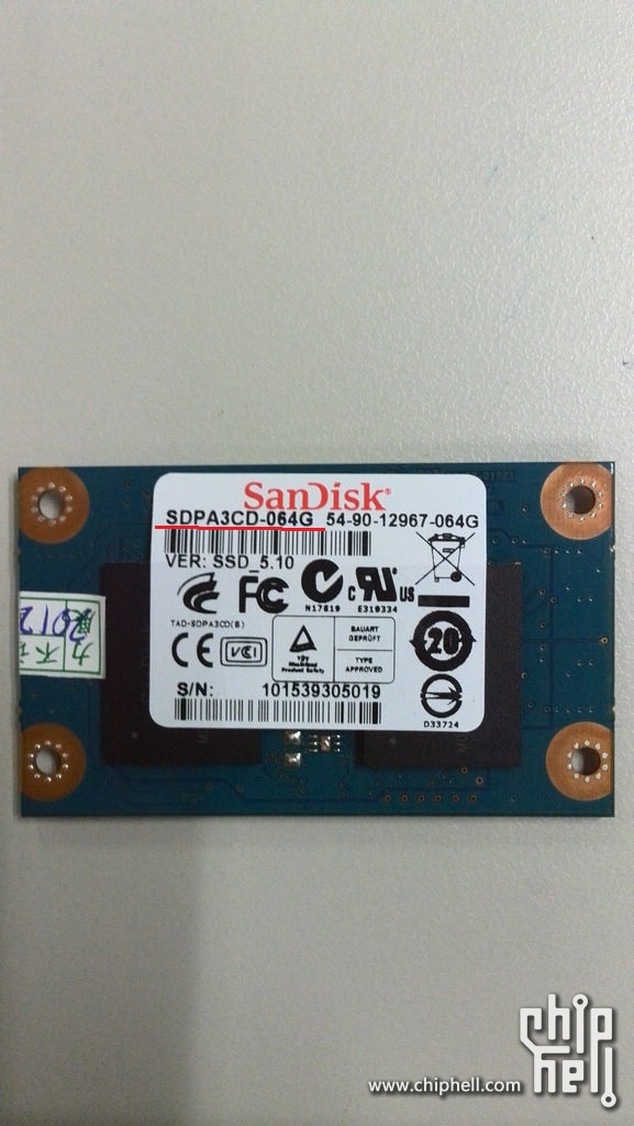

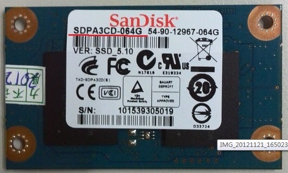

Guys, there has some problems with my classic, the battery in my classic was out of use, and I want to replace a new battery, also i want to place a new SSD in it, i tried to fix it, but is does not work, classic did not recognize the SSD, i found that some kind of ssd can work, but it only 64GB, I want to replace a 128GB SSD in it, can somebody give a list about which type of SSD can work well?
here is de pictures,
only sandisk SDPA3CD-064G works....
here is

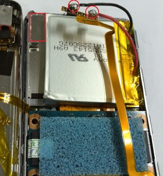

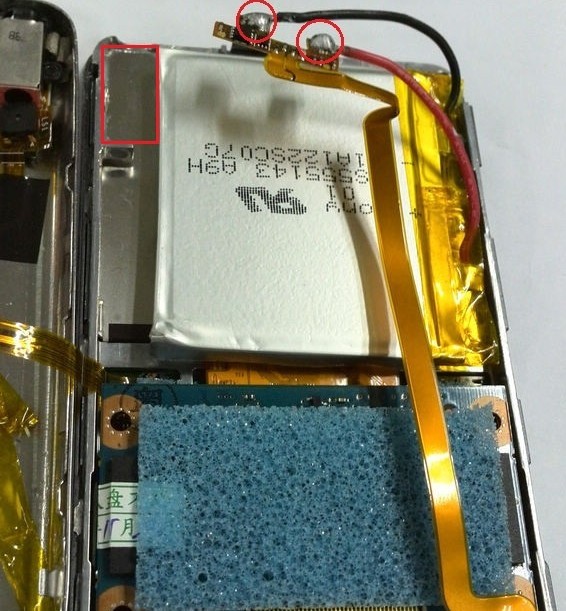

U misunderstand my point, I mean, when we use cover flow, the covers sometime can not present immediately, and if place a ssd in classic, the situation will change, not only in more faster cover flow, but also more power save(because ssd is smaller than 1.8 HDD, we can place a bigger battery in it). let me show u some pictures, some one place a new battery with more than 1500mh
