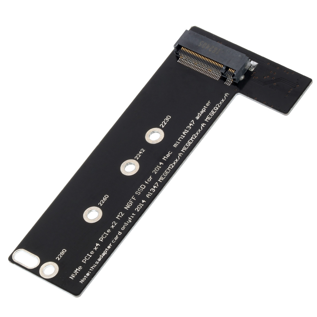

IMO: forget the SATA SSD. It requires major disassembly of the computer which carries the risk of damaging something and it will also be much slower than the PCIE option. Also, forget fusion drives, they no longer make any sense in today's world.
Just install a PCIE SSD and be happy. It will be fast, installation is easy and minimally invasive.

I just opened my Mini to check PCB. I do have the SSD flex connection on my board. I will give it a shot - order 3rd party ssd cable - SSD Blade and SATA SSD. I'll give this a try and get back to you.

Some dude/dudette posted this solution for Blade:
Of course questionable Chinese origin, but for $8.95 it's cheap.
This replaces the need for a custom Apple Cable + M2e Adapter for 3rd party.
I also read that Mini 2014 only has two lanes for SSD - so anything above this is overkill. Though any SSD purchased today can be repurposed for future upgrades (or pull for external case use).
