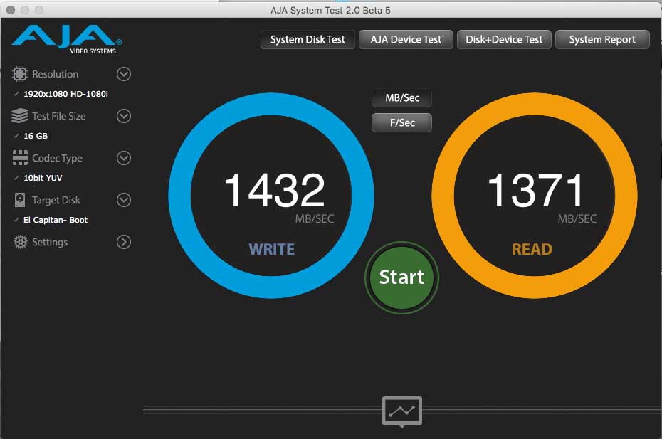

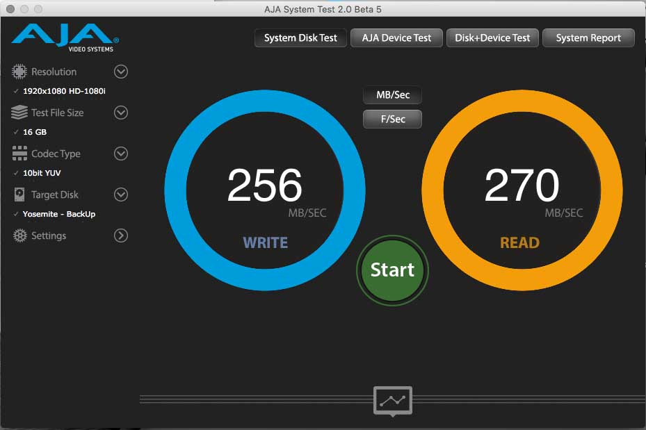

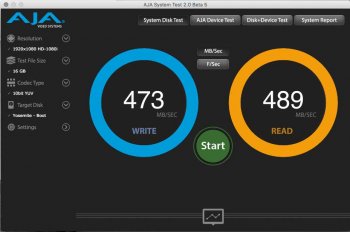

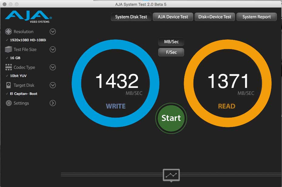

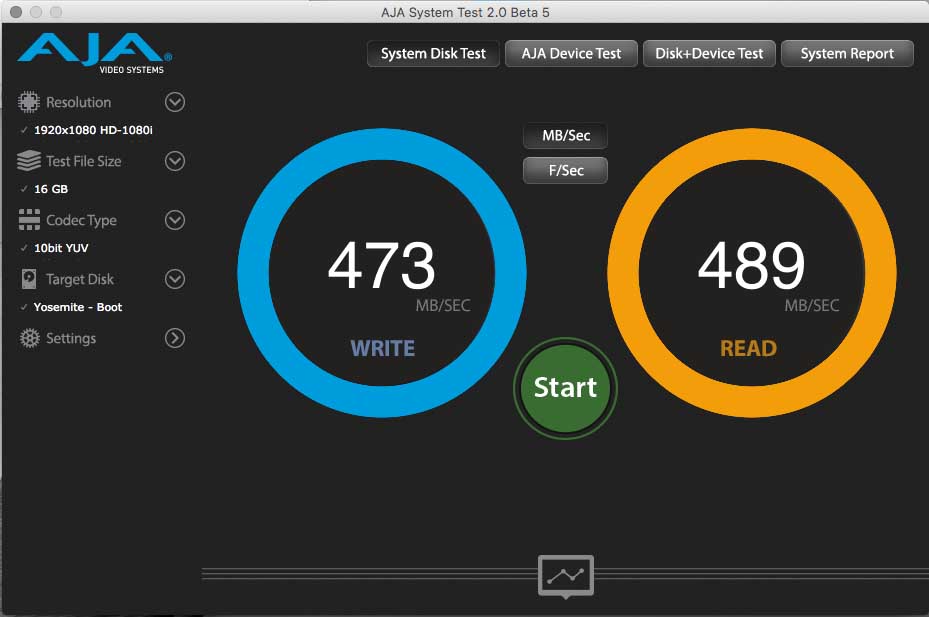

Your results are as expected. My results on a cMP 5,1:
1. SSD in SATA Bay
2. SSD in Apricorn Velocity Duo
3. SM951 on WINGS PX1
