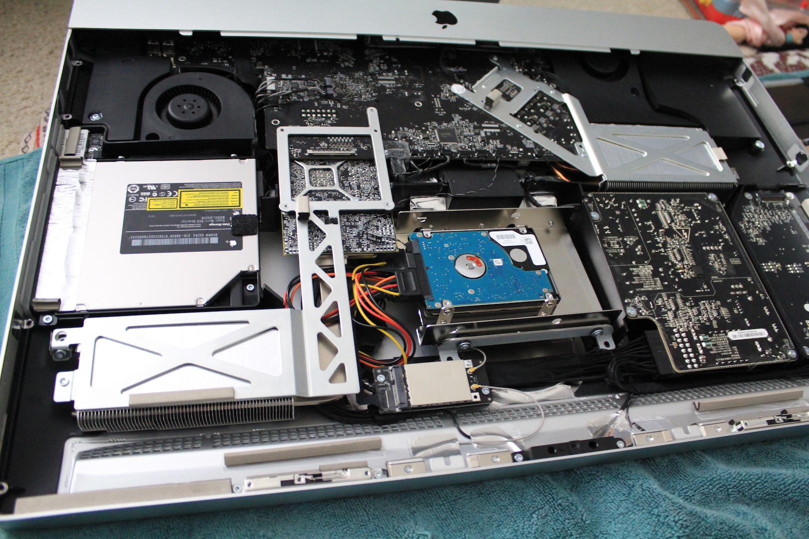

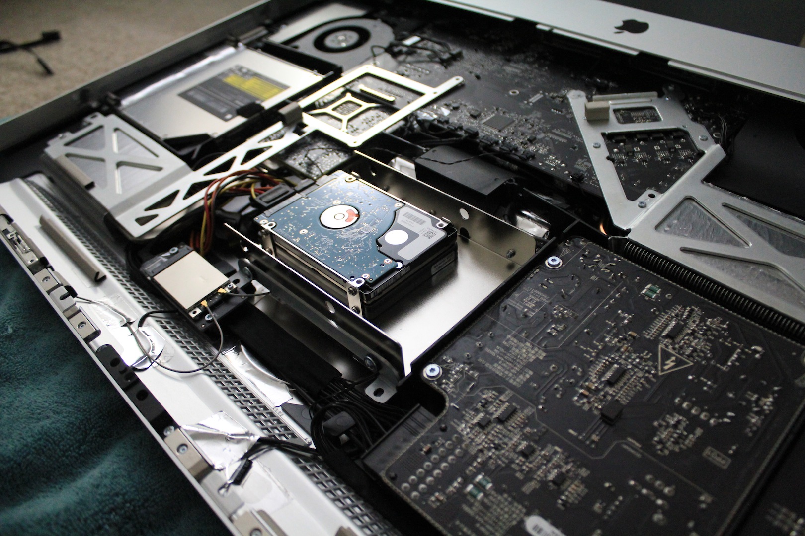

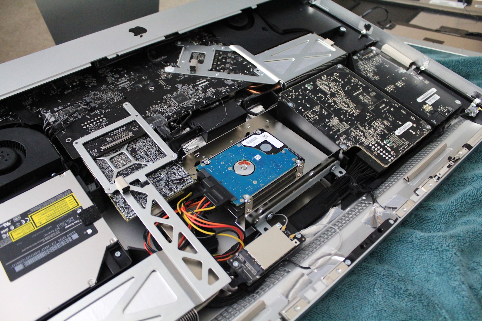

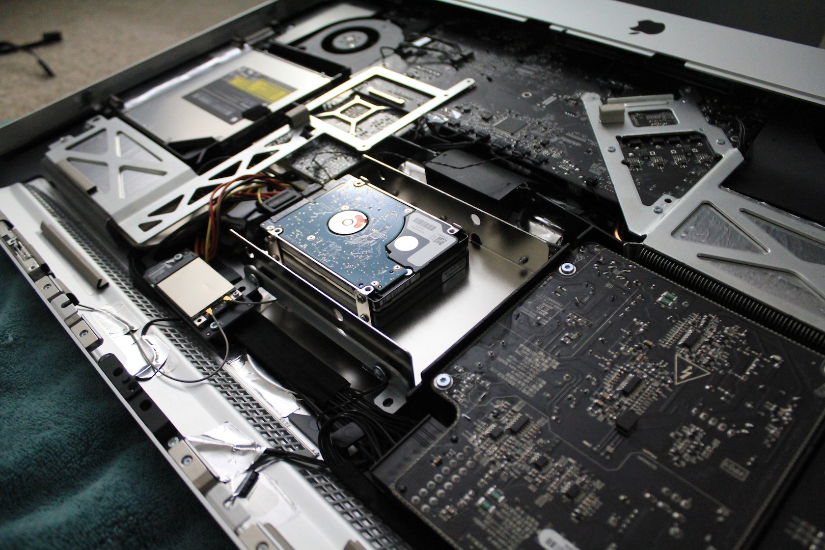

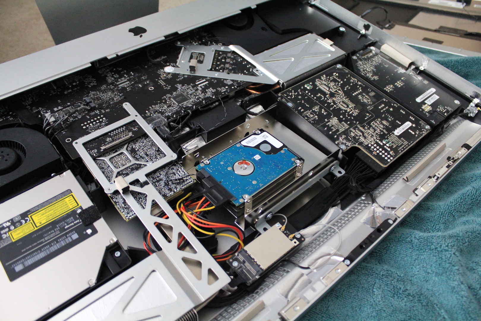

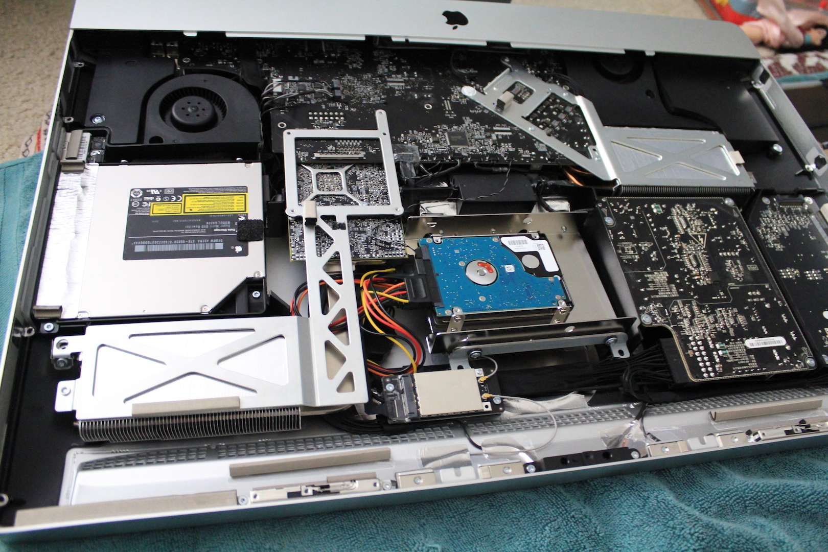

Yesss!! Today, I finally upgraded my mid-2010 i7 iMac by installing a 256GB Crucial C300 RealSSD and a 2.5" 500 GB Seagate MomentusXT Hybrid HDD.
I used the SilverStone 3.5" to 2.5" bay converter. Here are some photos of the installation. Sorry, couldn't take more pictures.
The original Seagate Barracuda 1TB drive is now my TM backup drive in an enclosure.
SSD rocks!!!

Awesome install! You mind posting your parts list you used for this install.
That's a good idea!
I'm just a bit concerned about the heating.
Havent had any heating issues yet. When the two drives are installed in the 3.5" adapter bay, there is a small gap of about 3-4 cm between them, allowing for airflow.

Did you need to take the mainboard loose at all in order to get the cables plugged into either SATA port for the harddrives?
The other topic about this added in the SSD (I believe he kept the standard drive in) behind the mainboard where it would be mounted if you ordered it that way I think. Putting two smaller harddrives in the one place is rather cool idea actually.
Yes, I had to loosen the motherboard to access the SATA connector for the SSD. The most difficult part for me was to remove the IR connector (I think) from the bottom of the mac, without which the MB would not slide up.
