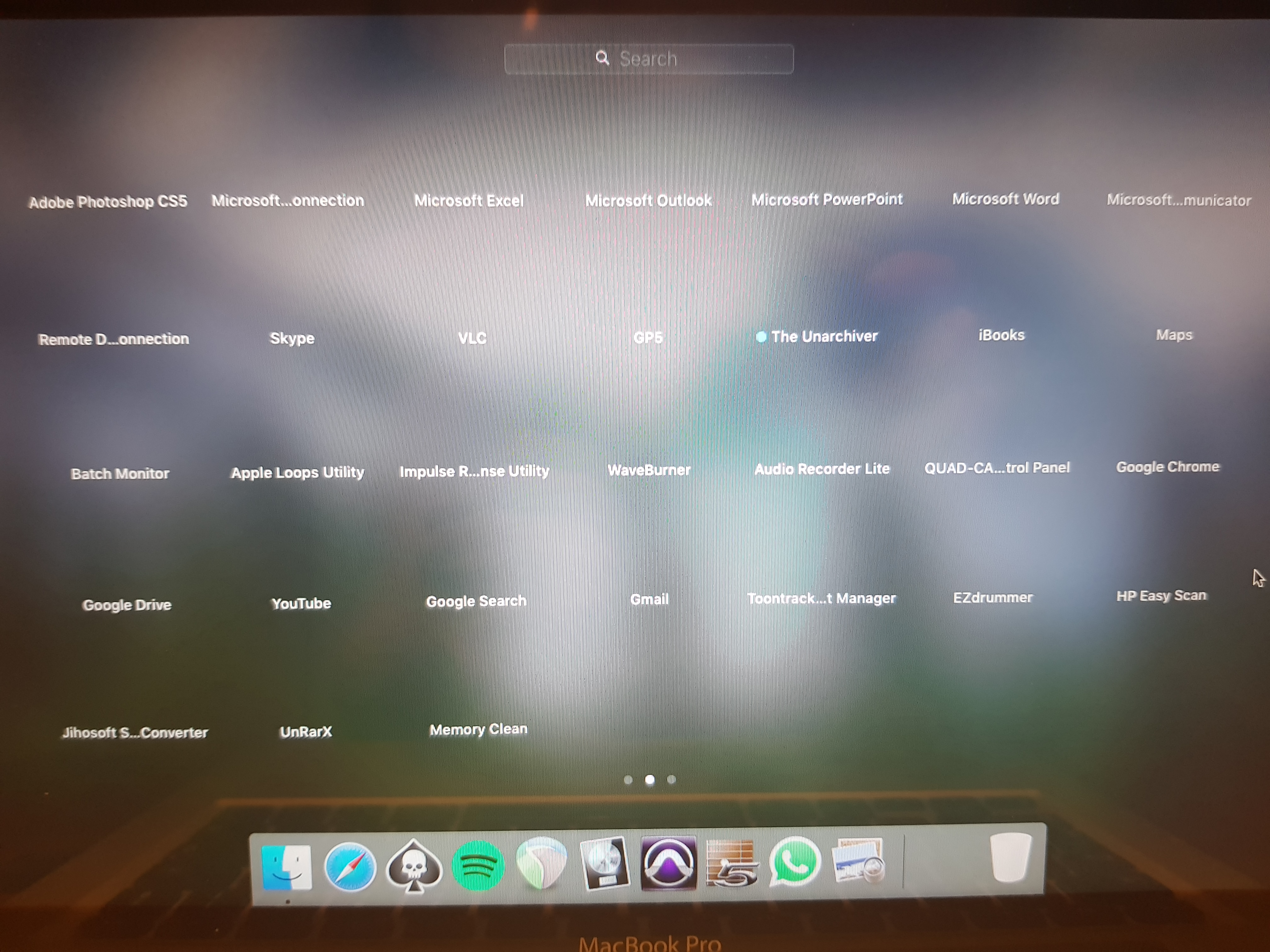

A few things happened in the mean time.
First it worked perfectly via the enclosure. Super fast, I opened a few heavy applications like Logic X and it was super smooth and fast. Then I shut down the macbook and put the SSD inside. First I saw a white screen with a block sign. Restarted it a few times and the 3rd time it worked after seeing the block symbol/screen again. I don't know if it was because I was waiting for a few minutes or because I pressed cmd R.
Logged in but I couldn't use any applications. No internet browser, logic or app store, nothing...
I put the HD back in and tried the SSD external. It started up etc. But then I still couldn't use any applications anymore. I saw it literally removing all the symbols. Then it said I couldn't open the application because it might be damaged (or incomplete I thought).
So I switched back to the HD and everything is working, pfew. I am definitely going to buy a new drive cable just to make sure. But I think its weird that it was working before...
A failing drive cable is not uncommon in the Macbook pro.
I have replaced three such cables using third party replacements from Amazon.
I will definitely do that.
Also tried it once more using the SSD with the enclosure. The pictures show what's happening.
