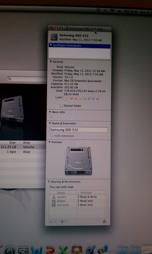

Sorry about that.. About this mac, System report, Serial-ATA then clicking on the SSD
Sorry about that.. About this mac, System report, Serial-ATA then clicking on the SSD see pic...
That is okay. That / is just the root of the drive and where the mount point should be. Not quite sure why it looked different with your other drive.
Did setting the startup disk like I mentioned fix the slow boot?
Interesting though... take a look how identified?
That is not a problem. You must have named the SSD that when you formatted it. You can leave it or change it back to the default Macintosh HD by following this video. It does not really matter. You could name it anything you want.

I called it 'Samsung SSD 512'
Please take a look at my install Lion and SSD data transfer via USB in my initial post, bottom sentence.. Is this why the Shift-command-g makes reference to it as a mobile backup .. or whatever..?

You are fine and that is normal. Here is a cap of mine with a 128GB SSD. That MobileBackups volume is used as temp storage by Time Machine when no external back drive is available.
