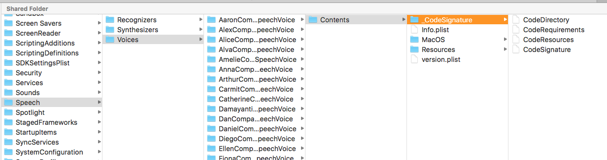

Hi guys, thanks for your help.
I've been getting a bug every time I restart my iMac with the SSD. I get this, it just comes up. How can I get rid of it?
