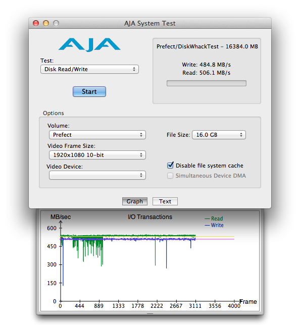

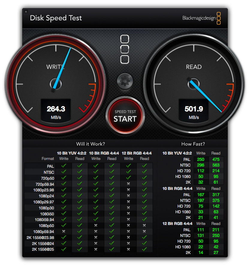

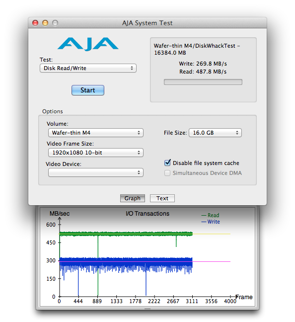

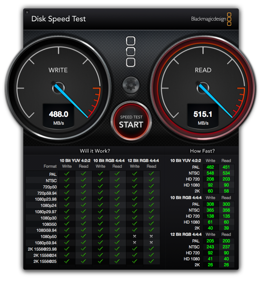

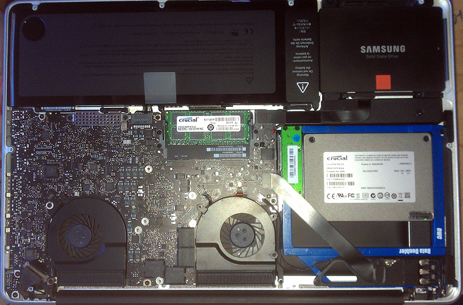

Thought I'd share my experiences with booting from the optical bay side in my 2012 15" cMBP:
I have a Samsung 840 Pro in the regular drive bay, and a Crucial M4 in the optical bay, using the OWC Data Doubler caddy. Both are 256GB SSDs.
I cloned the drives, and can boot from either one. Both show link speed AND negotiated link speeds at 6Gb. Both have TRIM enabled with the Trim Enabler 2.2 app. I should add that both SSDs are clones from the original 500GB HDD, not fresh installs. I used the SuperDuper! app.
These are BlackMagic and AJA System Test benchmark screenshots. You can see they both run close to or in some cases faster than their advertised speeds. The Samsung 840 Pro is on the current firmware as of today, and the Crucial is on version 0309. (I never updated that one past that, because it fixed the "5000 hour bug" and always ran perfectly in my Mac Pro and two MacBook Pros.)
You can tell which test is which by the speeds, but the AJA tests have M4 in the Crucial SSD test, and Prefect in the Samsung SSD test. (Named after a character in Hitchhiker's Guide to the Galaxy... not a misspelling of 'perfect'.)
As you can plainly see, the 2012 15" Classic MacBook Pro can boot at full speeds from either location without any problems with the OWC caddy. I currently boot from the M4 in the OWC caddy.

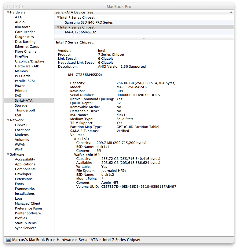

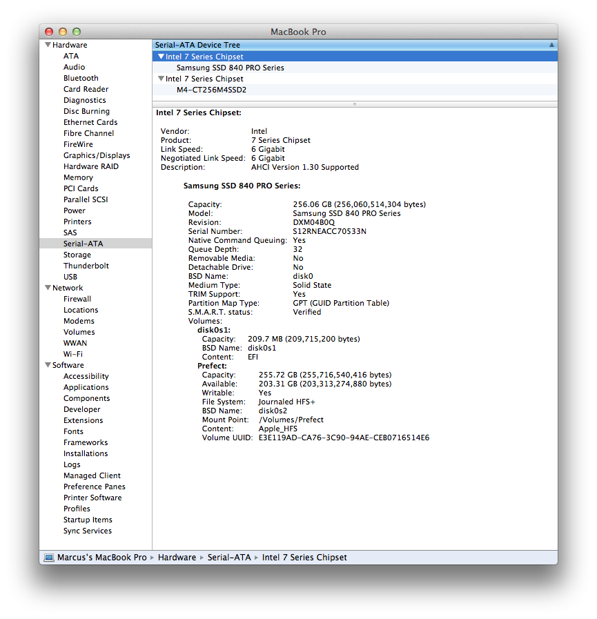

Screenshots showing link speed and TRIM support all working as well.
