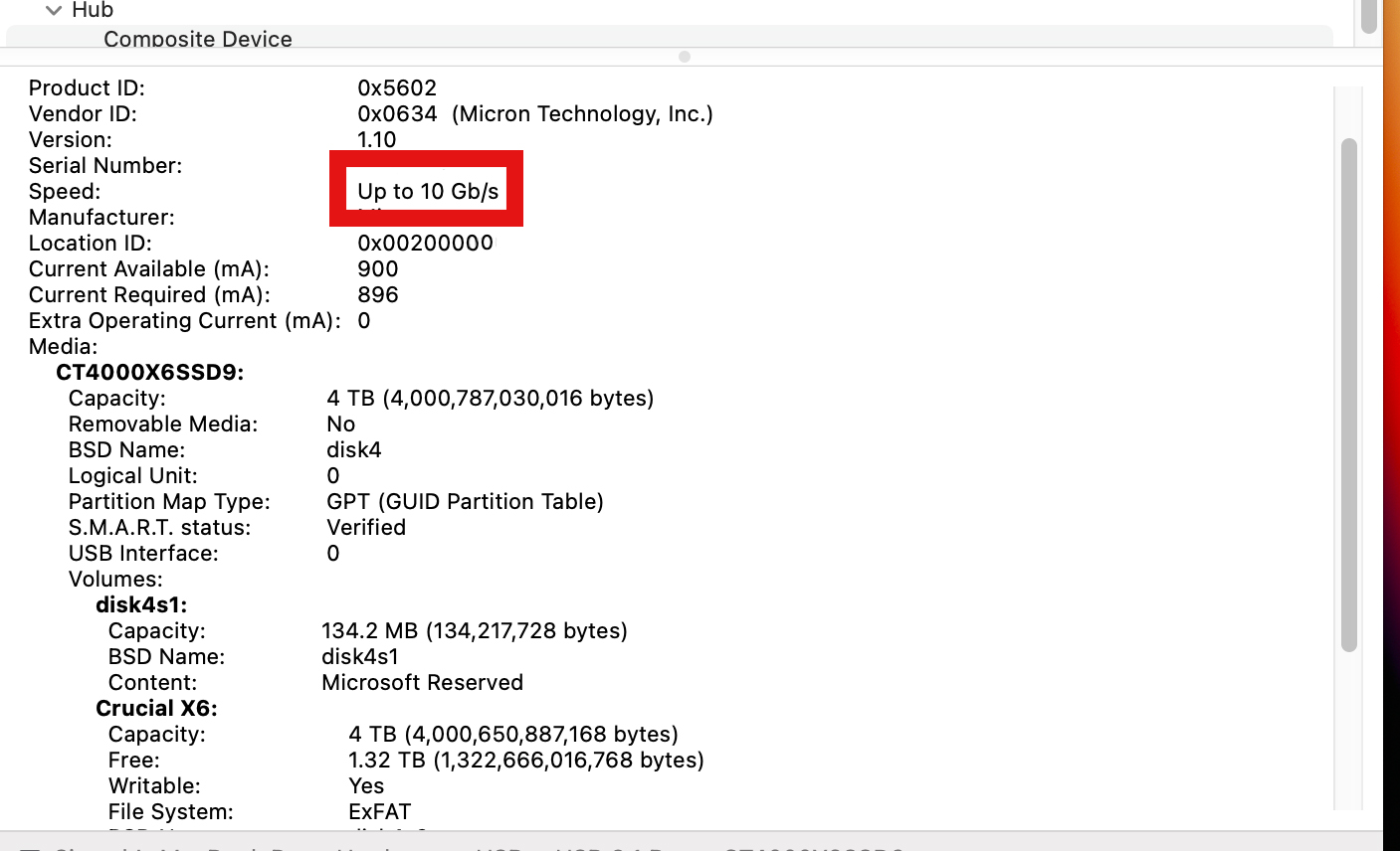

That's what it says:
The good news is that means it's not the drive itself that's the problem.
You can try reformatting the drive in APFS format. There are a number of reports that the file system drivers for ExFAT on Mac aren't that great, so you could potentially see a performance boost. The issue is that you would lose the data on the drive so you'd need to figure out a temporary storage solution.
