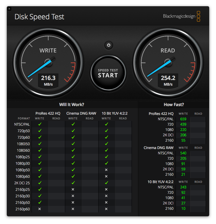

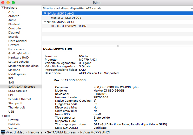

Hi everyone,
I have recently upgraded my iMac 21.5-inch late 2009 with SSD and everything is fine.
I have seen however some users with more speed on the same model (for example the video below).
My Black Magic Disk Speed Test is the follow:
SATA II is 3 Gigabit so theoretically up to 375 MB/s.
Any advice?
Best regards
Andrea Filippini

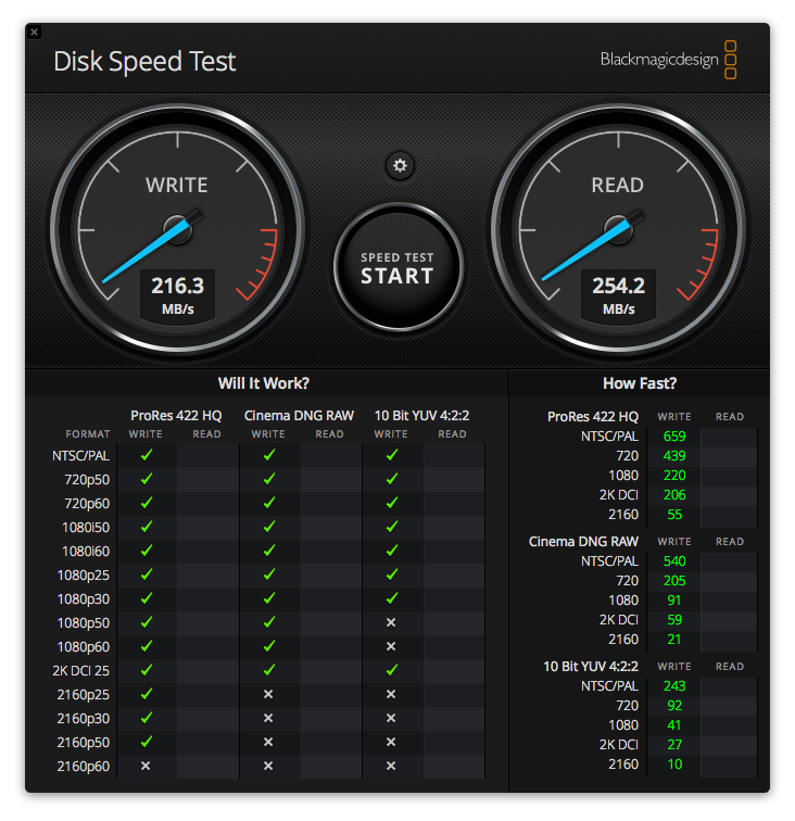

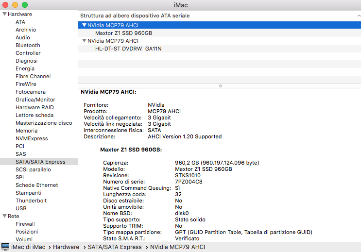

Hi everyone,
Any advice?
Best regards
Andrea Filippini

I just ran Black Magic on my late 2009 MacBook White and hit numbers maybe 10% below yours. Its a cheap Kingston SSD so I would not expect more but as others have said way better than the original HDD.
There are so many factors affecting the performance you get, bus speed in particular. You are seeing an improvement enjoy it or change your Mac.
Reactions: Andrea Filippini
The video shows speed quite close to what you're getting (i.e. within 5%) - so it could just be down to the test file size that was used in the video.
3Gbps is the link speed, not the throughput. Throughput is unto 300MBps and 10% will be used on transmission overheads - so max, in the best of the best cases (best SSD, correct file types/sizes, etc.) will be about 270MBps.
If I do the same Black Magic test on my daughters MBA the numbers are much higher. Link speed is higher 6Gpbs so whilst the other factors are very very important so is the initial 'grunt'. If you want faster disc access buy a newer computer.
