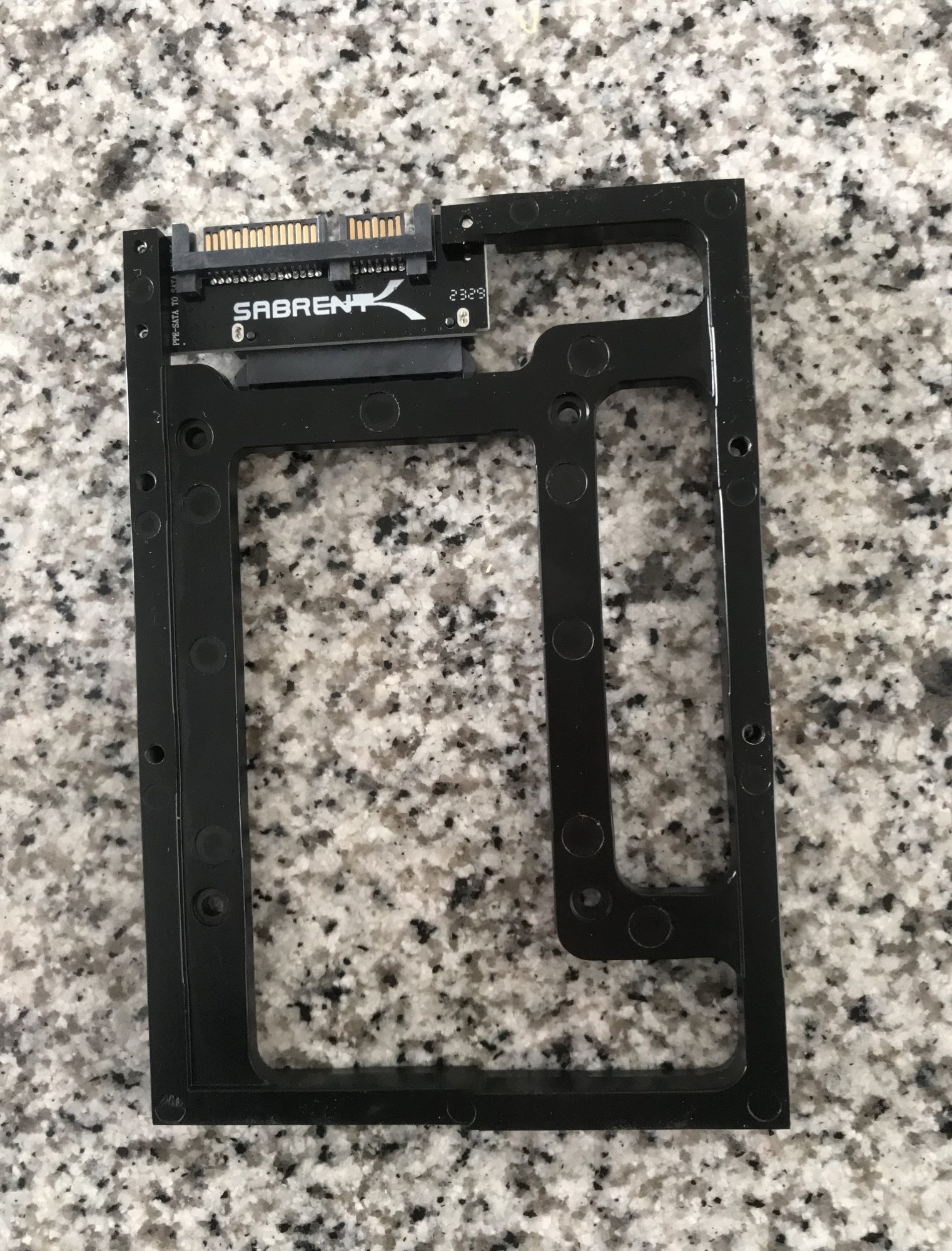

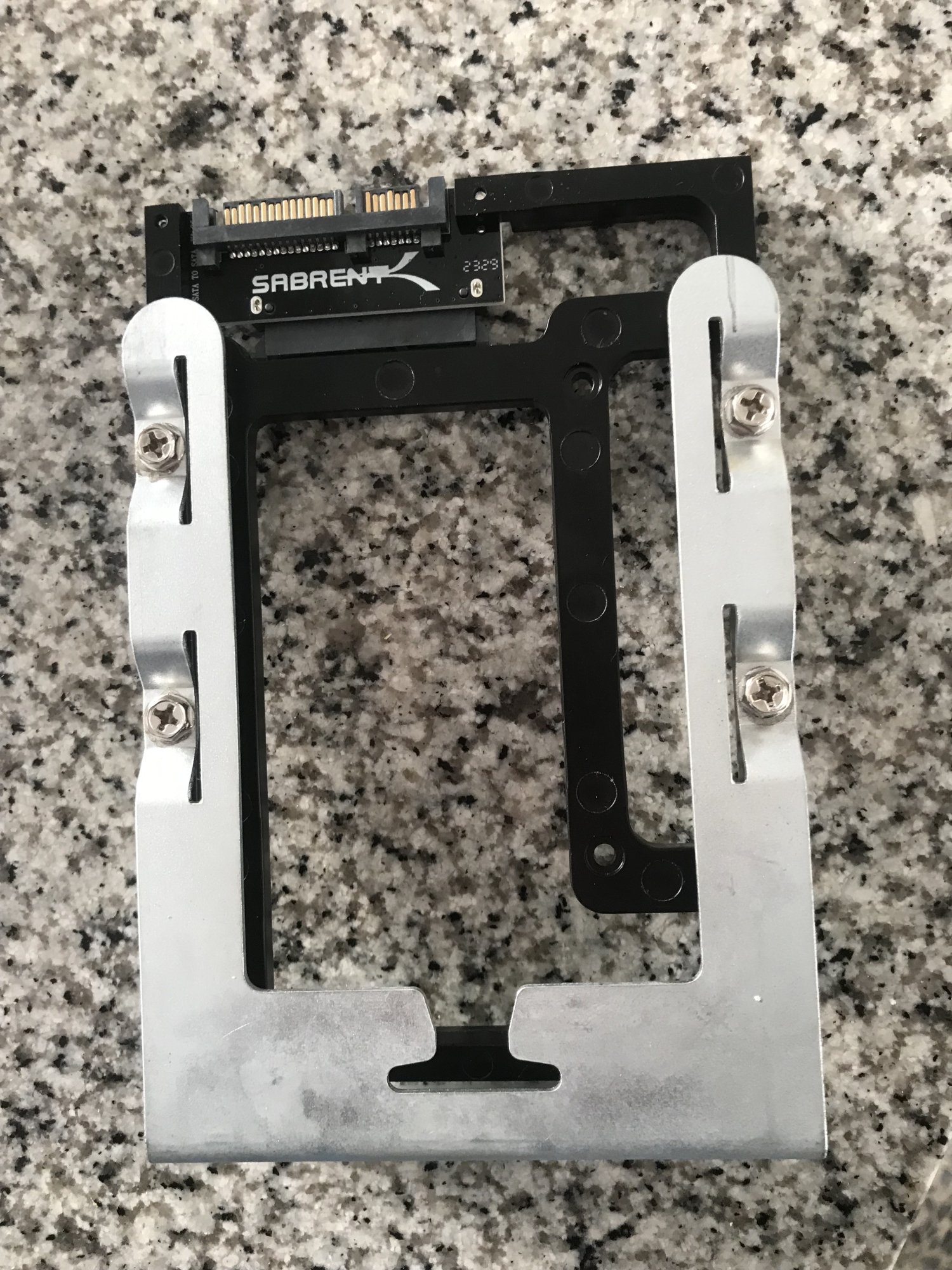

Yes, I've found it on Europe, for 26 Euros a pop! Considering the SSD itself was only 31 you have got to wonder what is going on in the world! I actually found a Sabrent adaptor similar in a box of disk related things. I'm wondering if this would work in the same way?

Yes, I've wondered if I could just leave it hanging, I've found the Sabrent version on Amazon, for 13 Euros, it says on the box that it is compatible with the Mac Pro, so it looks hopeful!
LookToWindward
macrumors regular
Oct 5, 2015
201
7
It works!
I'm going to buy a couple more of those adaptors, best option for people in Europe.
Thanks a lot for your help!

Great to hear the Sabrent adapter works as desired!
edit: While the ORICO adapter from Amazon.es in post #4 is only 10€, I just noticed the material is ABS.
So despite its look, it doesn't function as a heatsink - on the contrary.
And due to its larger footprint, it probably hinders the airflow in the Mac Pro slightly more than the Sabrent adapter.
