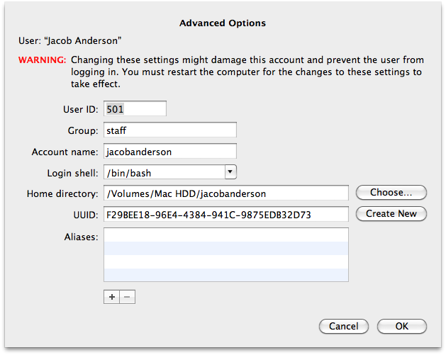

That's what it makes me think too... Yes, I do have the home folder located on the HDD.
First thing I would try is reboot and try again, if not it could be permissions, if this is the case you could try from terminal.

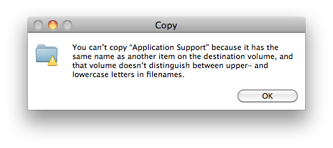

Now I can't even do a Time Machine restore of the Library on the HDD because it's giving me this message.
I was able to use time machine to backup all the user library files from early this morning to a newly created folder i made on the desktop. I hope it goes well, it's copying stuff now.
