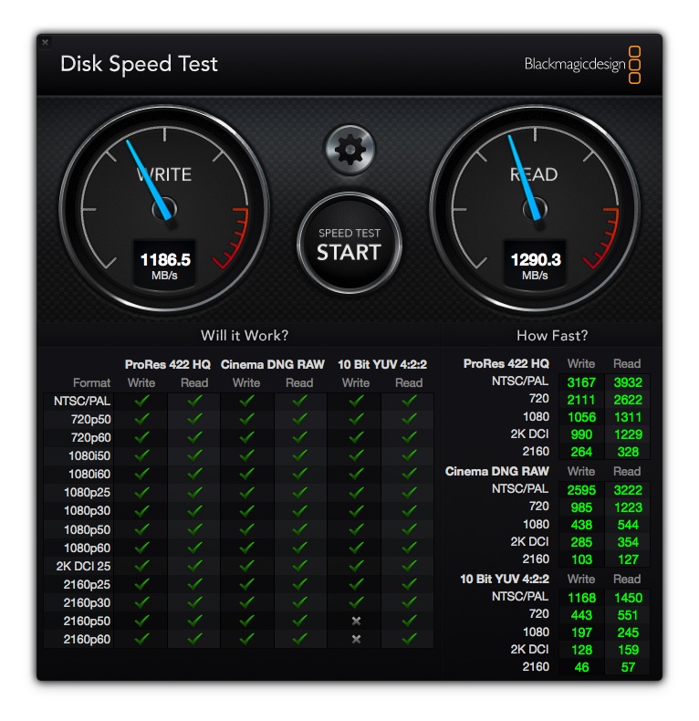

Go for a PCIE. I have one on my 2010 Mac Pro and it works brilliantly. This is with High Sierra.

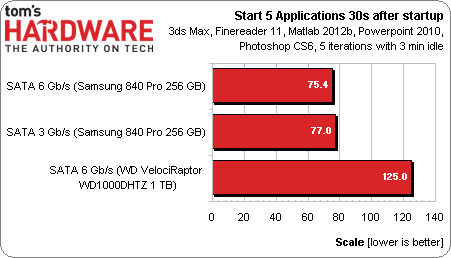

I didn't own any real PCIe SSD, but since their 4k random read speed cannot even saturate a SATA II connection. I didn't expect there will be any noticeable difference on boot time or apps loading (unless there is a huge library associated with a particular app). Also, form the above graph, you can see that the connection type (or bandwidth) is practically irrelevant to the boot time and apps loading time. As long as you are using SSD, the loading performance are more or less the same.

Anyway, the post above mine show you the PCIe SSD SEQUENTIAL speed, which is totally irrelevant to the boot time, and very irrelevant to apps loading time. What you really need is the 4k random read speed. Which usually about 30MB/s for most SSD you can buy (including the SM951). And a normal HDD's 4k random read is about 1MB/s, that's why the boot / apps loading time is significantly faster on the SSD. IOPS does matter, but not the sequential read speed in this aspect.
