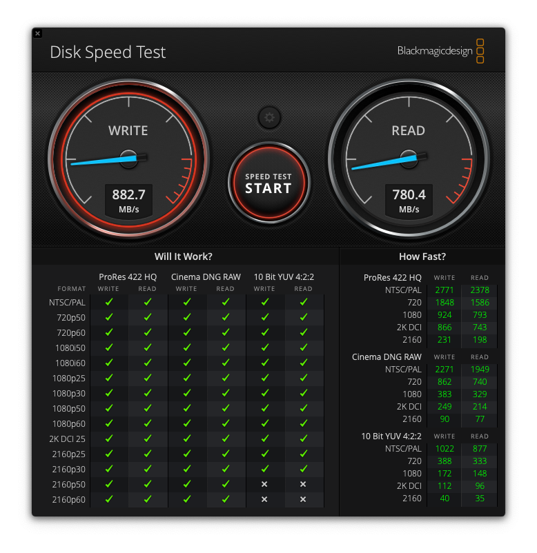

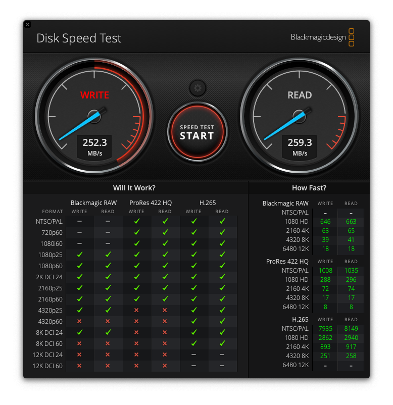

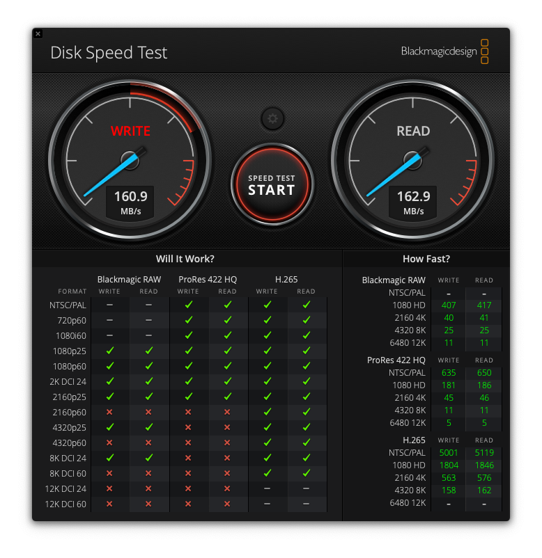

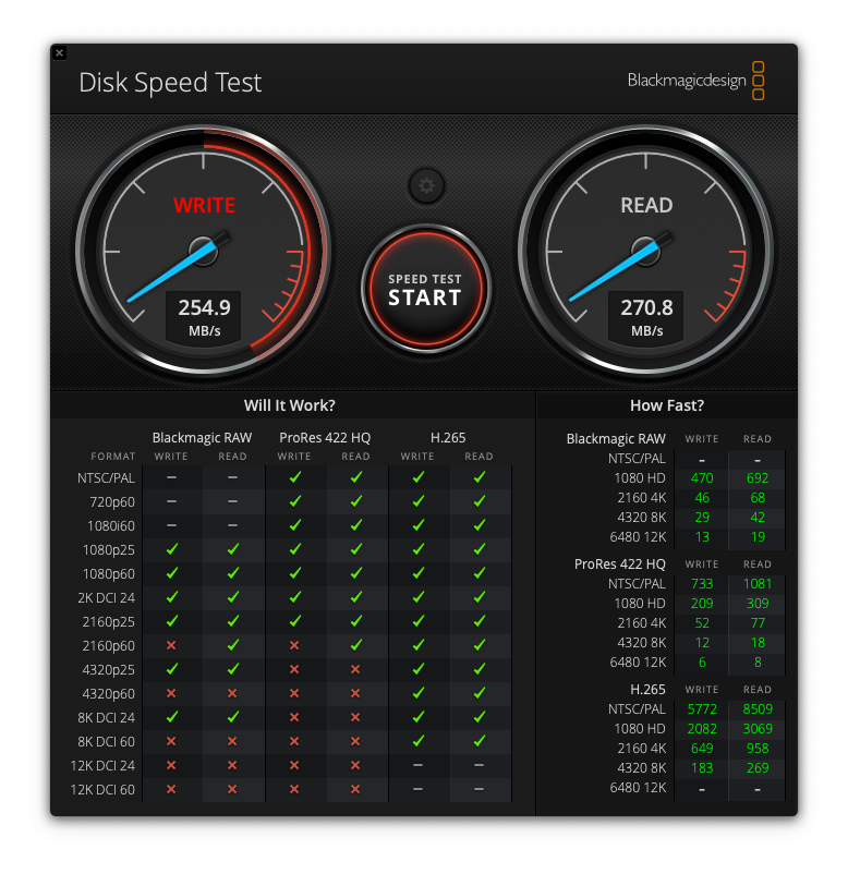

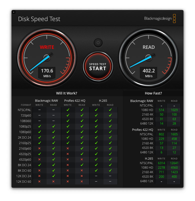

These are the speeds I'm getting with my setup. It's probably not useful, but whatever...
WD Blue 3D 2.5" SATA SSD 1TB [SATA slot#2]
HGST Ultrastar 7k4000 SATA 3.5" HDD 4TB [SATA slot#4]
Intel 730 2.5" SSD 480GB [SATA slot#1]
Intel 750 PCIe NVME SSD 400GB [PCIe slot #2]
WD Blue 3D 2.5" SSD 1TB (via USB3) (I can get peak write speeds in the low 400s, and peak reads in the high 400s)

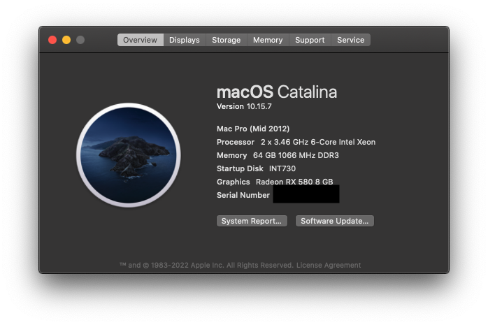

Here's my specs. This is a 5,1.
