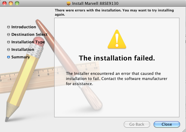

I haven't the kext you were referring to (AHCI_3rdParty_SATA.kext) and when i try to install i get this:
What OS? I've forgotten to say that it will work on 10.7+. Tested installer in 10.8.4 on my machine and it works without problems.

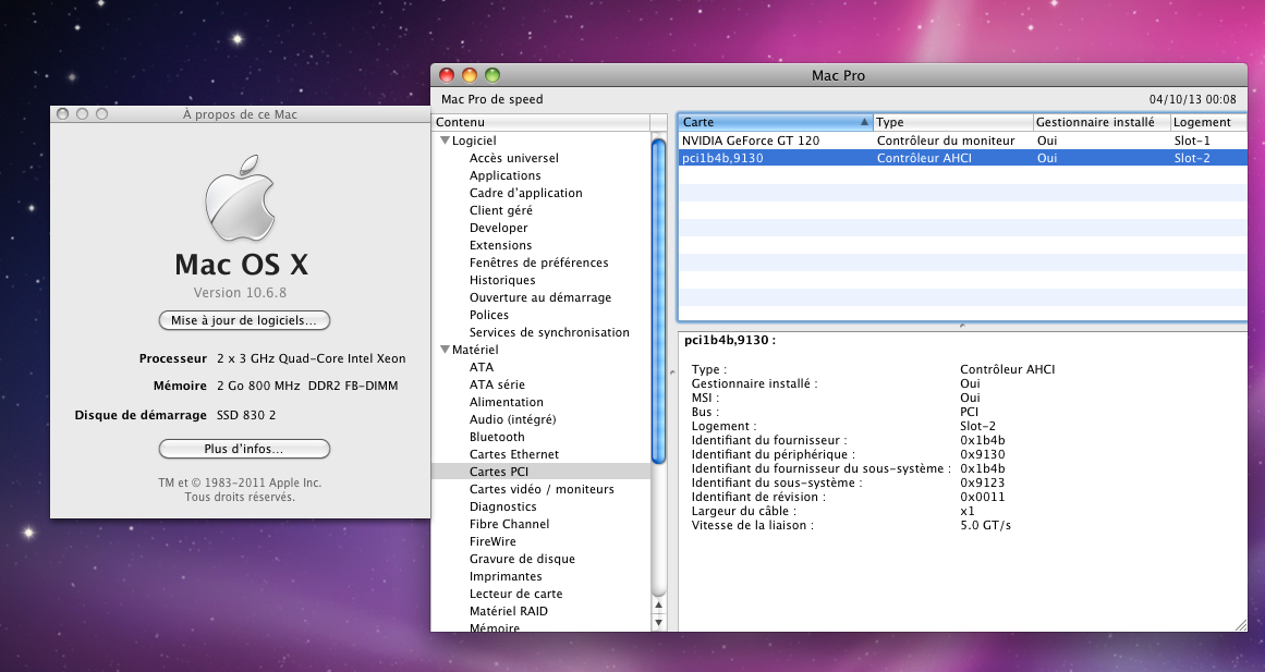

I've exactly the same. Working on 10.6.8, 10.8.5 both in Mac Pro 3.1 and 5.1
If you want boot an AHCI device, it must be without driver or extension, of course !

I tried to install on the 10.8.5 os and this is what i got:
