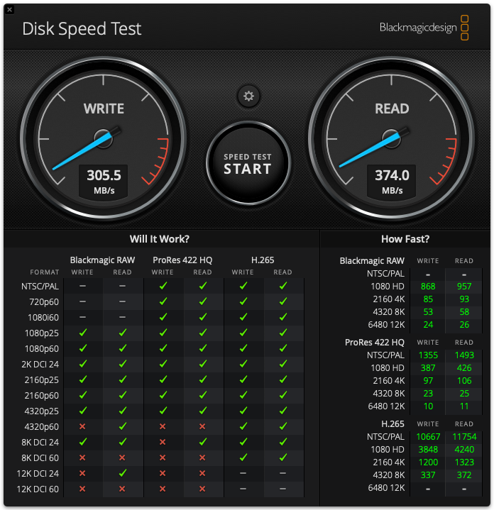

My macbook has frequently been crashing lately, and an EtreCheck report tells me that the SSD is failing. Attached is the BlackMagic disk speed test result. Please let me know if this is the major culprit.

Does look a smidge on the slow side for that model, but a failing SSD doesn't have to relate to speed at all. It's more about stability and maintaining what you store on it. If EtreCheck says it's bad you should probably back up your data (which you already should've before as well of course)

That’s definitely subpar performance. However, as pointed out by @casperes1996 , performance is not a great gauge of HDD/SDD health.

Performance looks suspicously low to me and I would probably replace it if it was mine. You are fortunate in that model of laptop allows a drive replacement even if not with an off-the-shelf NVMe SSD. Your drive looks like it is running at 1/2 - 1/3rd expected while a new drive in that system should run ~ 2x faster than original (~1.5GB/sec).
Based on your other notes you are using an external drive as your boot drive as well as primary storage don't normally use this drive at all. So it's possible its been this slow for a while and/or this is actually normal. However, quick read of reviews of this laptop when it first came out suggest it normally did >1GB/sec read and >500MB/sec write. When hardware -- especially storage -- starts to slow down relative to new/normal, I become suspicious.
It helps then to isolate a potential hardware issue from a potential software issue. Since you aren't using it for your OS, etc I assume backing it up to your primary and overwriting it with a new filesystem wouldn't be hard? If so I would try that and then running the disk benchmarks again. If it returns to spec, probably wasn't a hardware issue. If you get errors during the process and/or performance is still low, I would replace it.
P.S.You should also run that disk benchmark on your primary external drive just to rule out other system issues that affect all drives and have a reference comparison. In theory your external drive shouldn't be any faster than the internal drive that came with that system. Maybe somewhat faster writes if your external drive is of a better model and Thunderbolt 2 connected.
