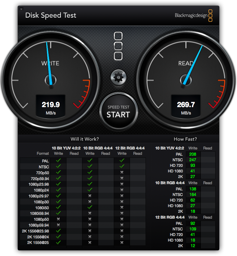

I have a MBP 17 2010, equipped with a Vertex 2 SSD 120GB as boot disk.
It's an old hardware but I don't want to change it, the problem is the SSD is performing poorly :
The SSD health report is not so bad (except for temperature, which I dont understand) :
the SATA link looks OK :
EFI version is the latest :
but the speed, especially write speed, is quite the half of the Vertex 2 public benchmarks.
Any help ?

Did the SSD slow down over time, or is this the first time you tested it?
Most of the OCZ SSDs from that era used the Sandforce controller, which uses compression techniques to achieve it's advertised performance.
But the Blackmagic speed test (and many real world applications) use binary/incompressible data which results in slower speeds that claimed by OCZ and other vendors using the Sandforce controller.
You could also have some other sort of problem, either the SSD or the SATA cable. But if you are just worried about the numbers not matching the claims from OCZ, that might be the reason.

Thank you for you response alex0002.
Is the first time I run the bechmark, the disk is almost empty. I didn't kwon about compression, maybe is the cause.
As I said the disk health look quite good, do you know some diagnostic SW ?

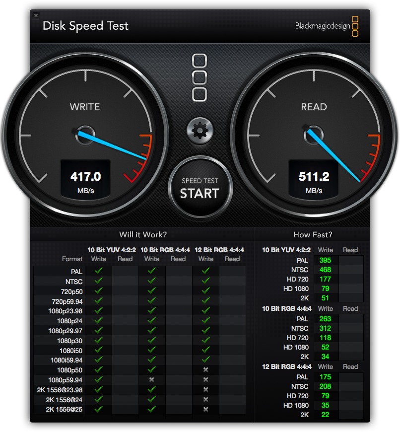

that is pretty low for SSD, i have also 2010 13" Mbp with SATA2 link speed, here's my single SSD and Dual SSD.
