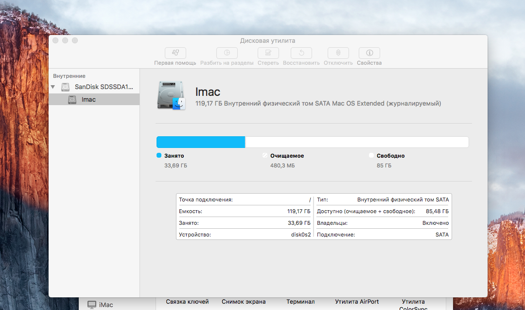

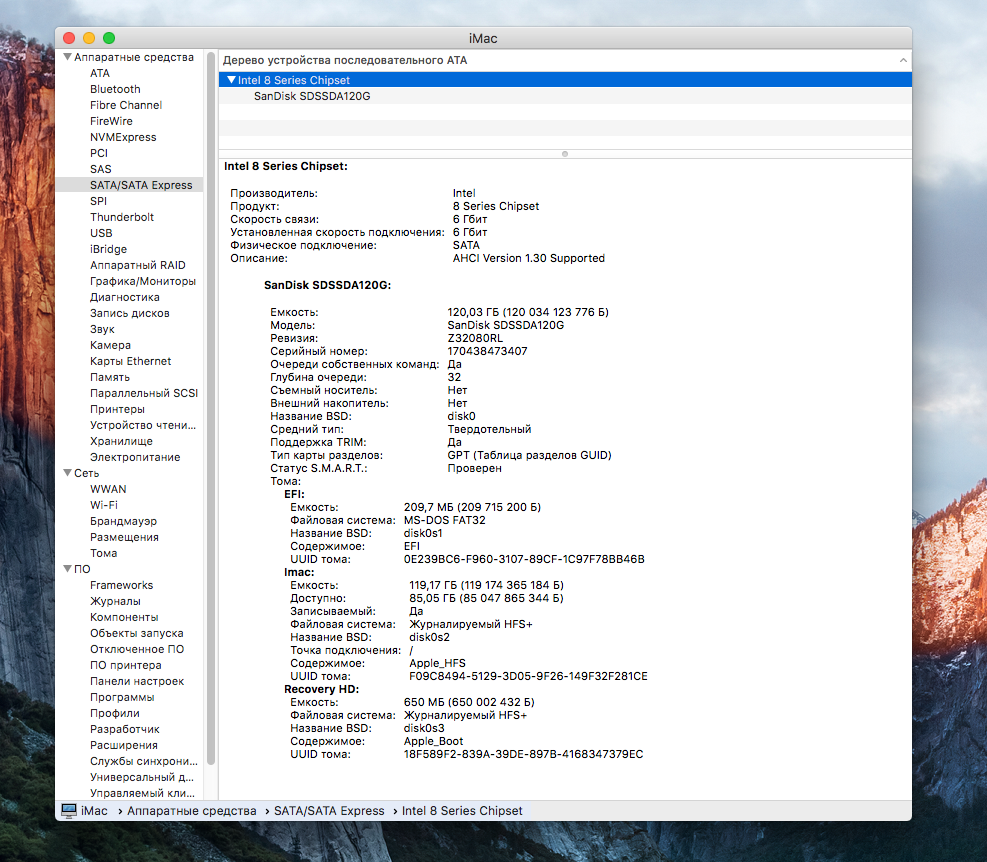

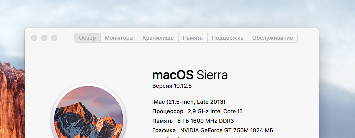

Снимок экрана 2017-05-21 в 9.07.26.png Снимок экрана 2017-05-21 в 9.08.01.png
I'll go out on a limb here and say that the performance issues are because its a cheaper 120 GB SSD without as many NAND chips to write to in parallel.

You haven't told us much, but from what I can tell it looks like you put a Sandisk 2.5" SATA SSD into an iMac?
If so, the speeds you're seeing are normal and fairly decent for a small-capacity drive.

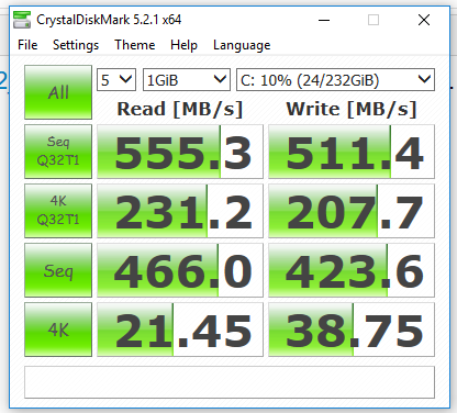

The reason your speeds appears to be unstable is because its testing different variables. Take a look at my CrystalDiskMark from my WD Blue SSD which has similar performance to the SSD Plus however its 250gb which will inherently be faster than 120gb.
Notice the speed the inconsistencies between test? That is what the level gauges are showing during the test in Blackmagic.
