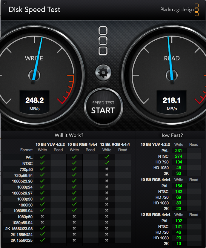

I got my new iMac 2012 in December and put in a Samsung 830 256Gb SSD in it very soon after getting it.
Recently I have noticed that things have been slowing down. So I ran Blackmagic speed test and I have decreased from just under 500Mbs transfer rate to around 200Mbs.
I have Enabled Trim Support etc.
Can any one explain whats happened to my transfer rate and how i can get it back?
Thanks

How full is your drive? Verify again that TRIM is enabled, set sleep to never, and let it sit idle overnight.
Thanks, I did go and investigate Trim support.
Turns out it got turned off,
I suspect this happened when I took my iMac to get a repair.

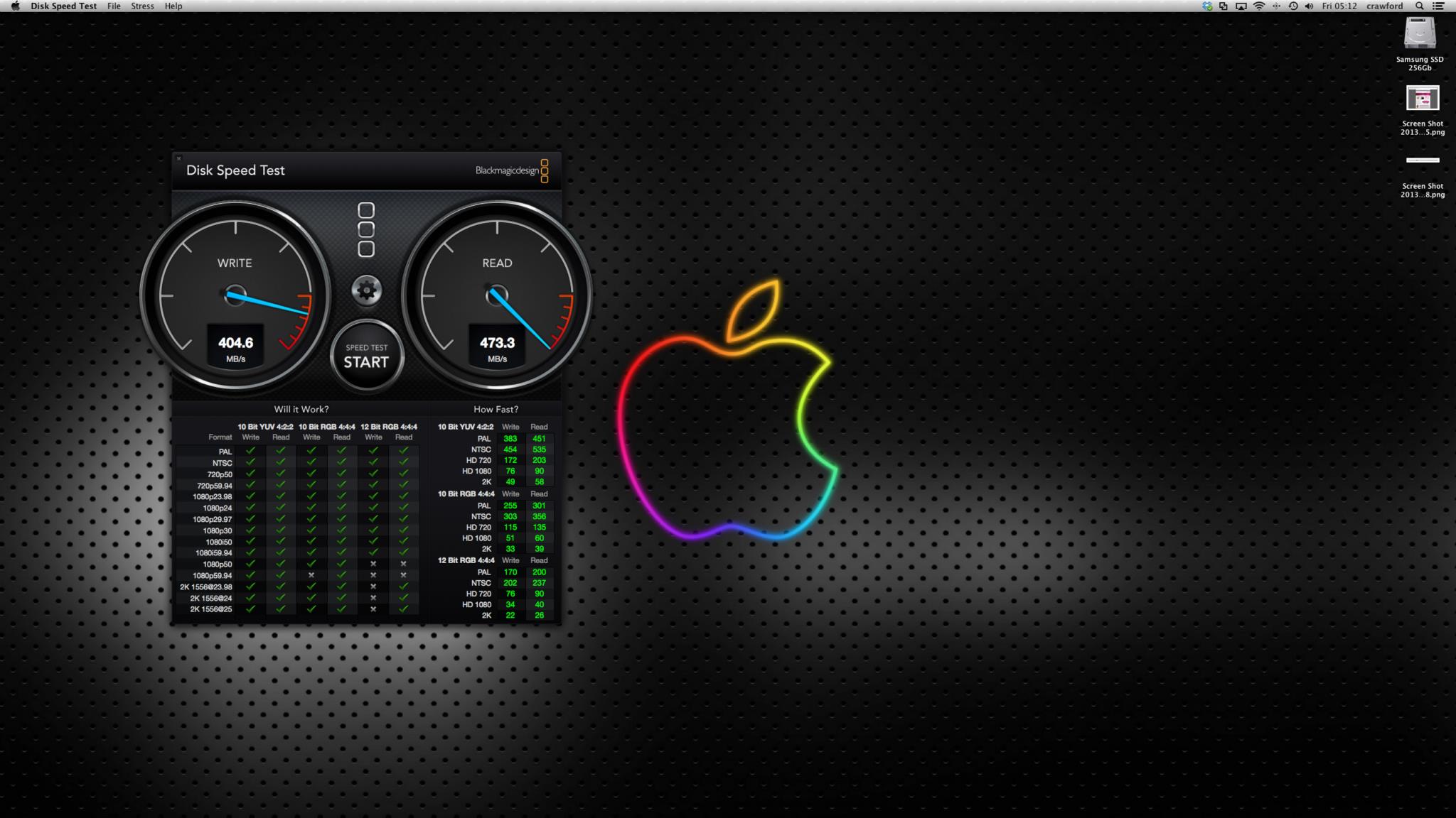

I tured Trim on, restarted poped to the shops back up to 500Mbs 🙂
Thanks for your response
It usually gets turned off with each OS X point update because the tweaked kext files are overwritten, so it probably got turned off when you updated to 10.8.3.
