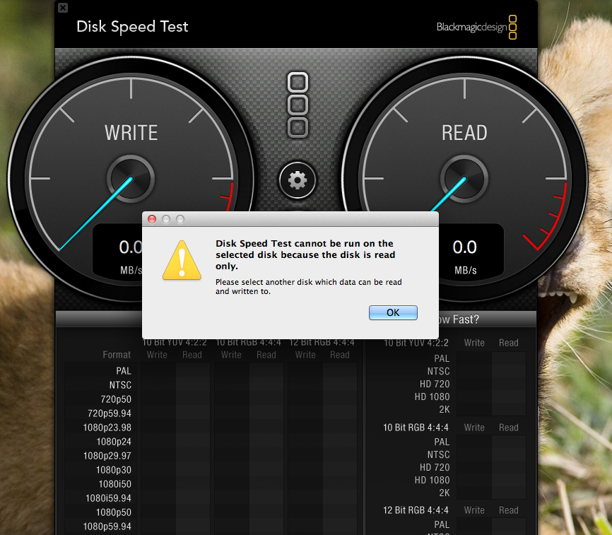

I "just" installed my new Crucial 256GB SSD w/ Firmware 2. I transferred over all of my files, and my MBP boots in 15 seconds. I would like to use Black Magic's DiskSpeedTest to see my speeds.... and when I open it I get a message saying the disk is read only. I am confused as to why this is....How do I go about fixing this? Is it a problem?
Edit: I seem to be able to do everything else.. Is there a test to see why this is happening?

Right now I'm reinstalling Lion. See if that helps.
I had the same problem and this is how I resolved it:
Right click on your SSD > get info > add your user to access and permissions and set the privileges to read and write.

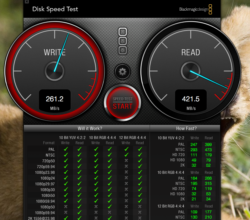

Fixed it though.

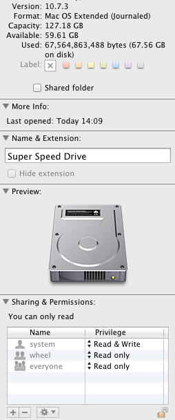

i have just installed a crucial m4 128gb SSD in a 2011 mac mini i am also using it as boot drive with the 500GB stock drive for media. whenever i try to change permissions i get unexpected error -8076 the drive seems to work fine i get boot times of around 10/15 seconds. i have attached image of get info page.
I'm not sure how the wheel group gets added to the user group for Macintosh HD mount point. It should not be visible and only member is root. Certain apps like Blackmagic will have write issues because wheel is used instead of admin. I recommend trying repair disk permissions first. I ended up adding the admin group myself then ran repair permissions.
