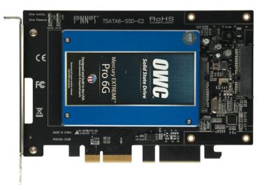

You can also just install your SSD on a Sonnet Tempo and keep the space for another hard drive available.

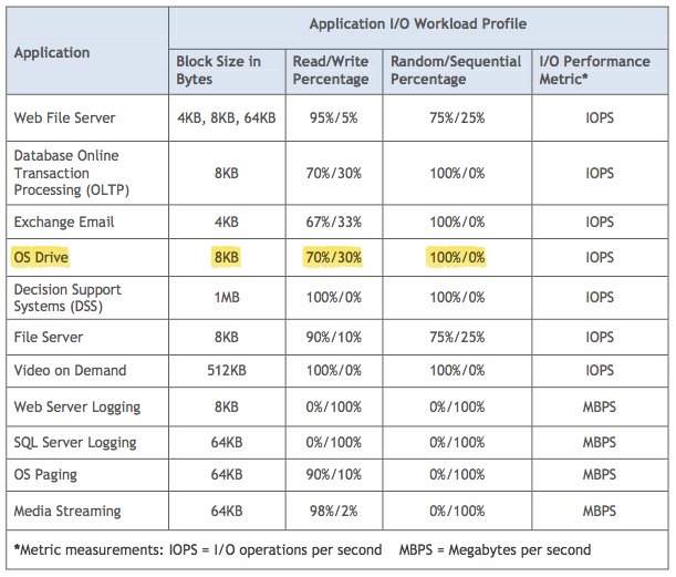

To understand why SATA3 is largely unnecessary for an OS/Apps drive, you really need to understand storage I/O access patterns for this kind of workload. Almost every researcher and benchmark utility on the planet characterizes an OS or workstation load as 80% Read, and 80% Random with an average 8K transfer size (see the chart below for a comparison). StorageReview.com uses exactly this storage pattern in their Workstation benchmark.
Of course, there's a lot more focus on this kind of research for server workloads, but there are still enough data points around that all suggest that your OS workload is primarily small random reads.
The only kinds of workloads that will push sequential workloads are sustained copies and large media files... but even those are usually not big enough, and therefore don't take long enough (at 275MB/s) to read or write for you to notice. Furthermore, a lot of I/O is actually CPU bound. Large files aren't just loaded directly into RAM... they need to be processed/rendered by the CPU.
Now with that knowledge in hand, if you look at any SSD benchmarks, you'll see that SSD's, while a couple orders of magnitude better than old HDDs are still only able to achieve around 20-30MB/s on random small block I/O.
So as I said before, a SATA3 interface will make your benchmarks look good, but it won't make even the slightest difference in every day use on an OS/Apps drive.
Now if you're moving large TIFF files or HD video files around, yes, SATA3 and RAID0 are your friend, but for the OP... it's probably a total waste of effort and money to migrate his SSD to a SATA3 interface. And I can tell you from first hand experience... it makes ZERO difference. (But I do store my photo libraries on a RAID0 Array of SSDs on a SATA3 RAID card).
