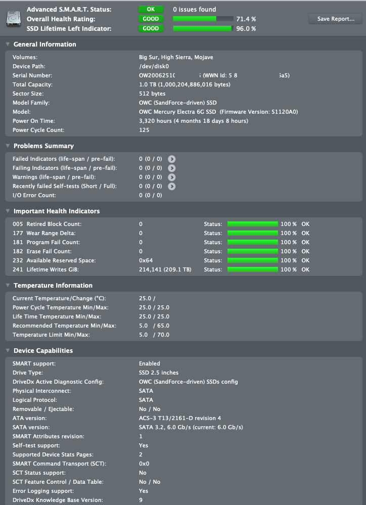

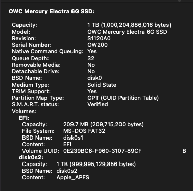

Yeah, that was the first thing I checked. Here is the dump of info for the drive below.
I also wanted to note that this happens in Mojave as well as Big Sur.
Does anyone have any idea what could be causing this problem then if its not a bad cable?

The drive is only about 4 months old. The problem exhibits itself if I copy a 6 GB file, which is not a lot. The specs for the drive say it should be about to sustain writes up to 500 MB/sec. The issue I am seeing is that the copy drops down to about 10 MB/sec which is almost stopped. Then it picks back up and goes fast for a brief few seconds and then drops down to almost nothing.
If I'm reading the output correctly to have written to a 1TB drive over 200TB in just four months, so you do appear to be a heavy user.
You've done writes that would take most users of that drive several years (maybe more than what many would ever do with that drive even if they keep it for several years) in just four months.
I think you chose the wrong drive for your use case.
From what I can gather the Electra is aimed at those who want fast speeds but on a budget and who may from time to time write a lot of data, but not 100s of GBs every day. For your kind of use case you want a Pro drive, whether that's the OWC Extreme, or one of the Samsung Pro's with a 10 year warranty or similar.
Wiping the drive may help but ultimately this SSD won't last you nearly as long as a professional grade SSD would.

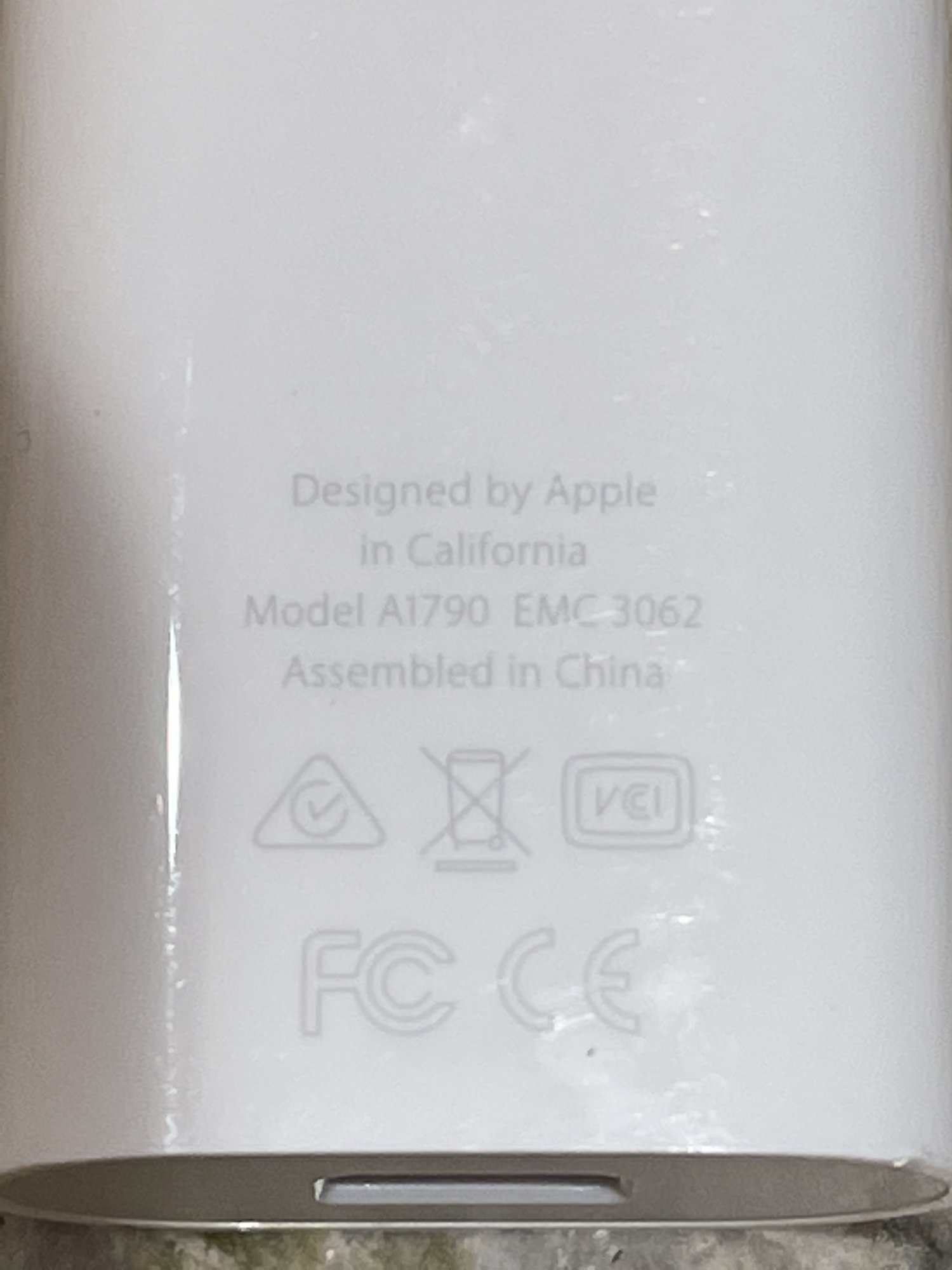

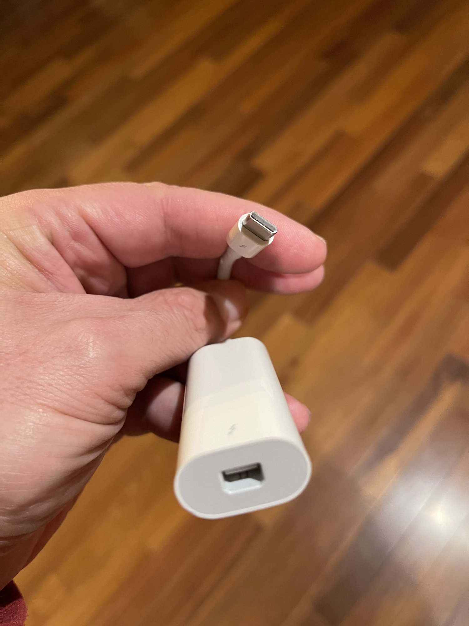

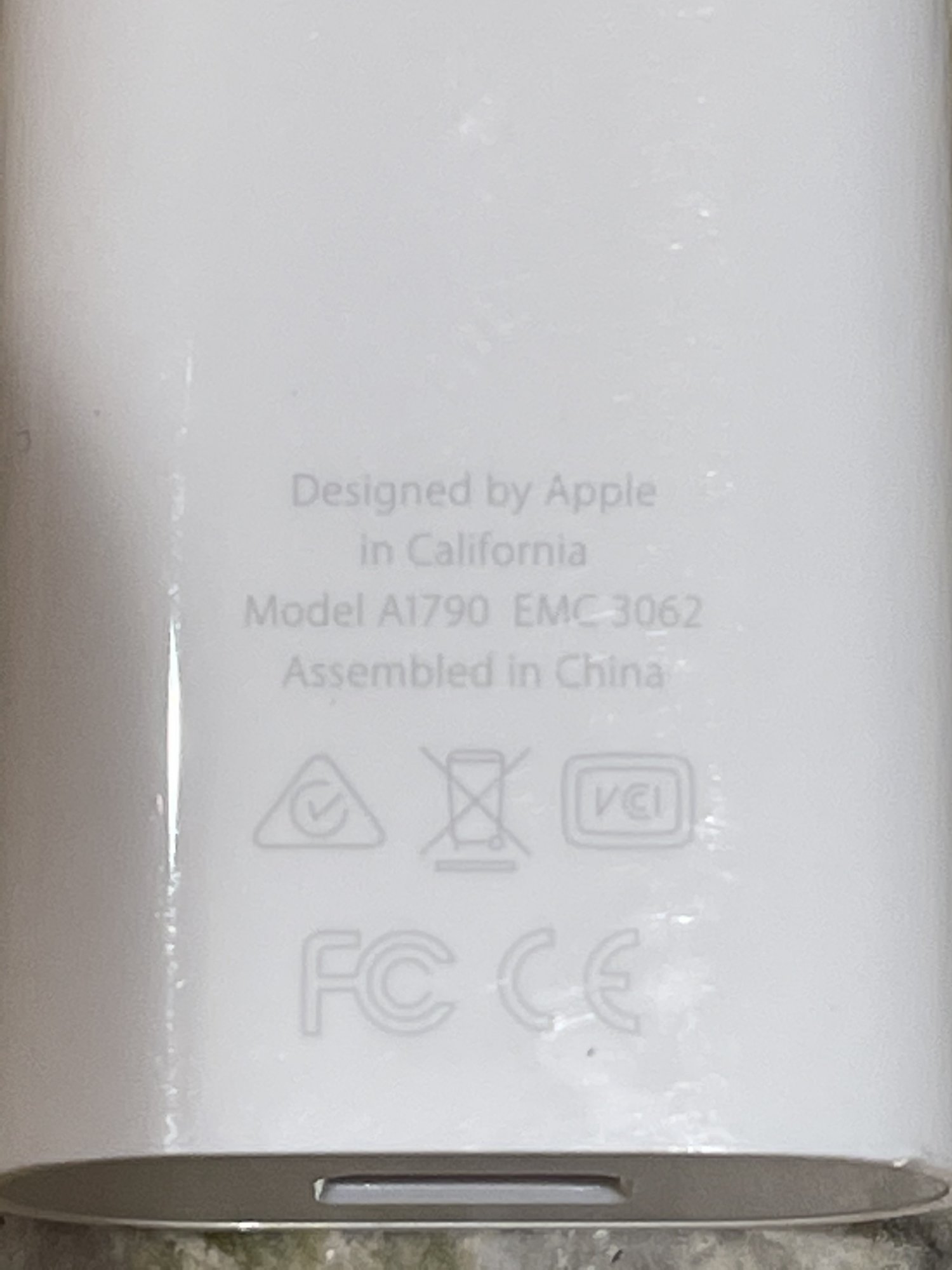

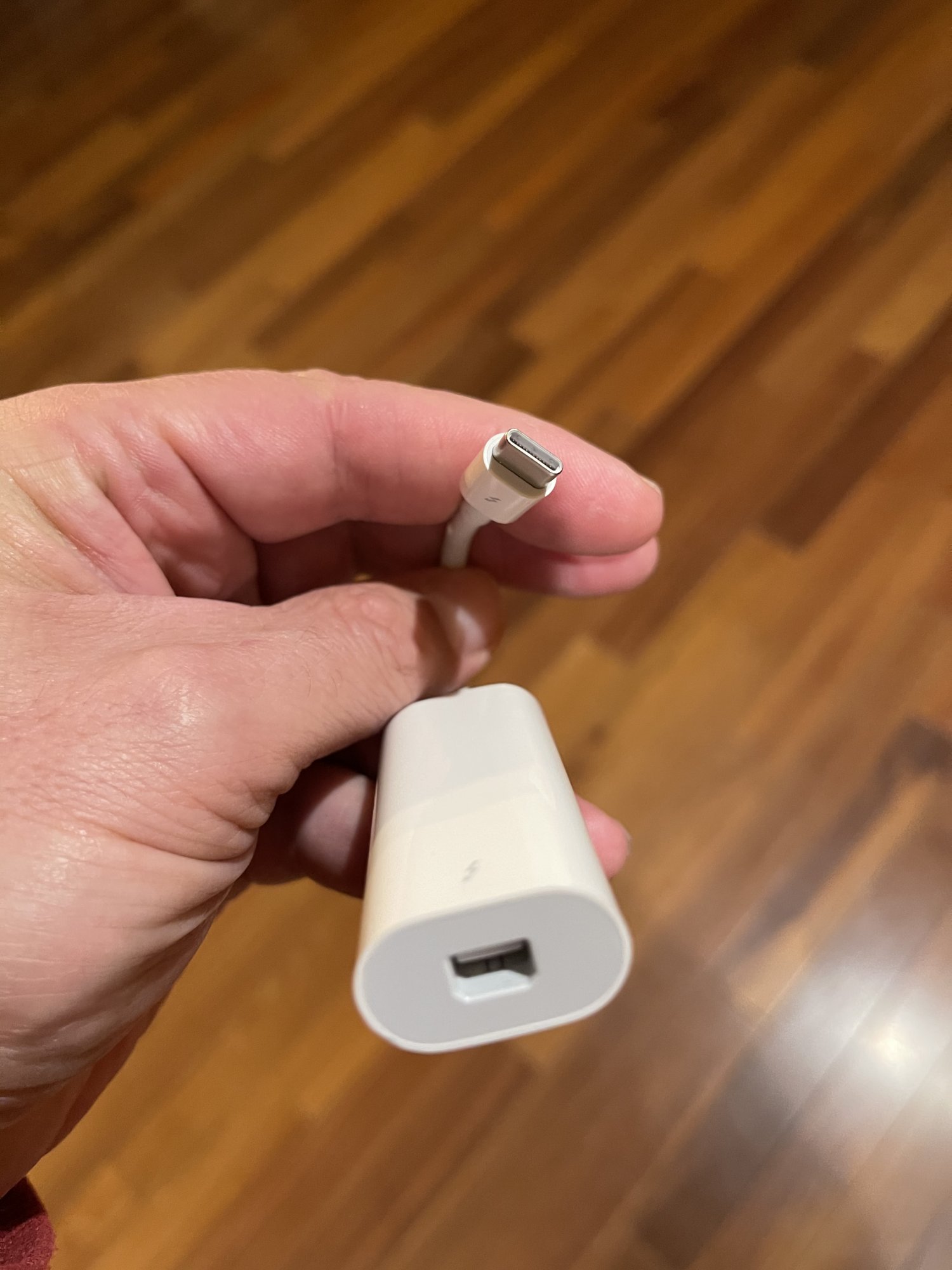

I think I have one of these adapters and a cable. I’ve used the cable for target display mode in the past. This is the right adapter isn’t it?

That looks like the right adapter, yes and is what you would use to connect it to a TB3 Mac for use with TDM. You connect a TB (1/2) cable to the 2011 iMac and then connect the other end of the cable to that adapter. The Apple adapter is TB3 to TB2 (TB1 and TB2 use the same connector and it is backwards compatible). Whilst TB3 has the same connector as USB-C they are not the same. You can't plug a USB-C device into it. Be careful about marketing. Read the specs and manual to make sure the drive is actually TB3, not just using the same connector.
The adapter does not transfer power, so you either need a TB3 drive with an external power supply or a TB3 dock with a power supply to supply power to the drive.
