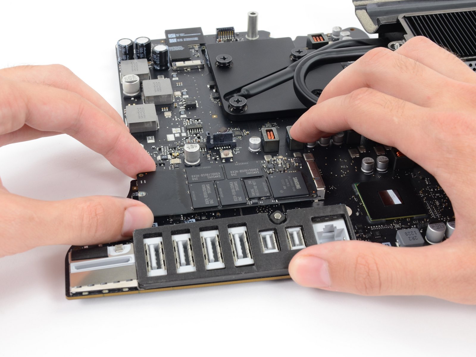

This is the single blade slot essentially for any 2012 to 2019 27" iMac:

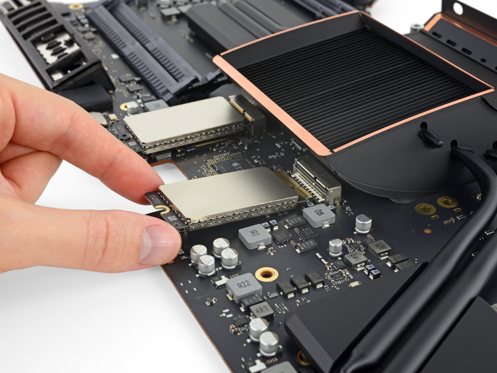

... and this the dual slots for the 27" iMac Pro:
Source: iFixit.
