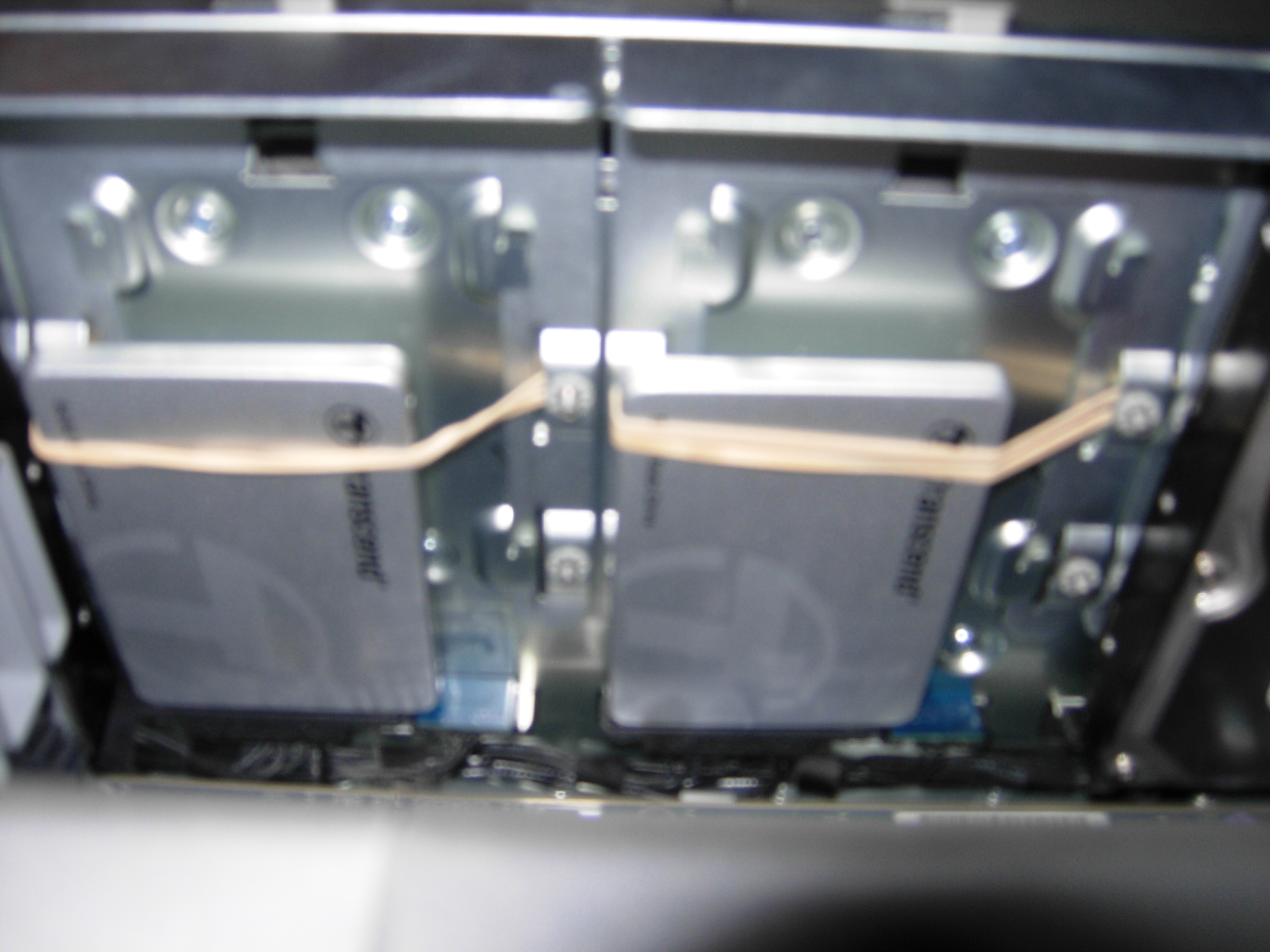

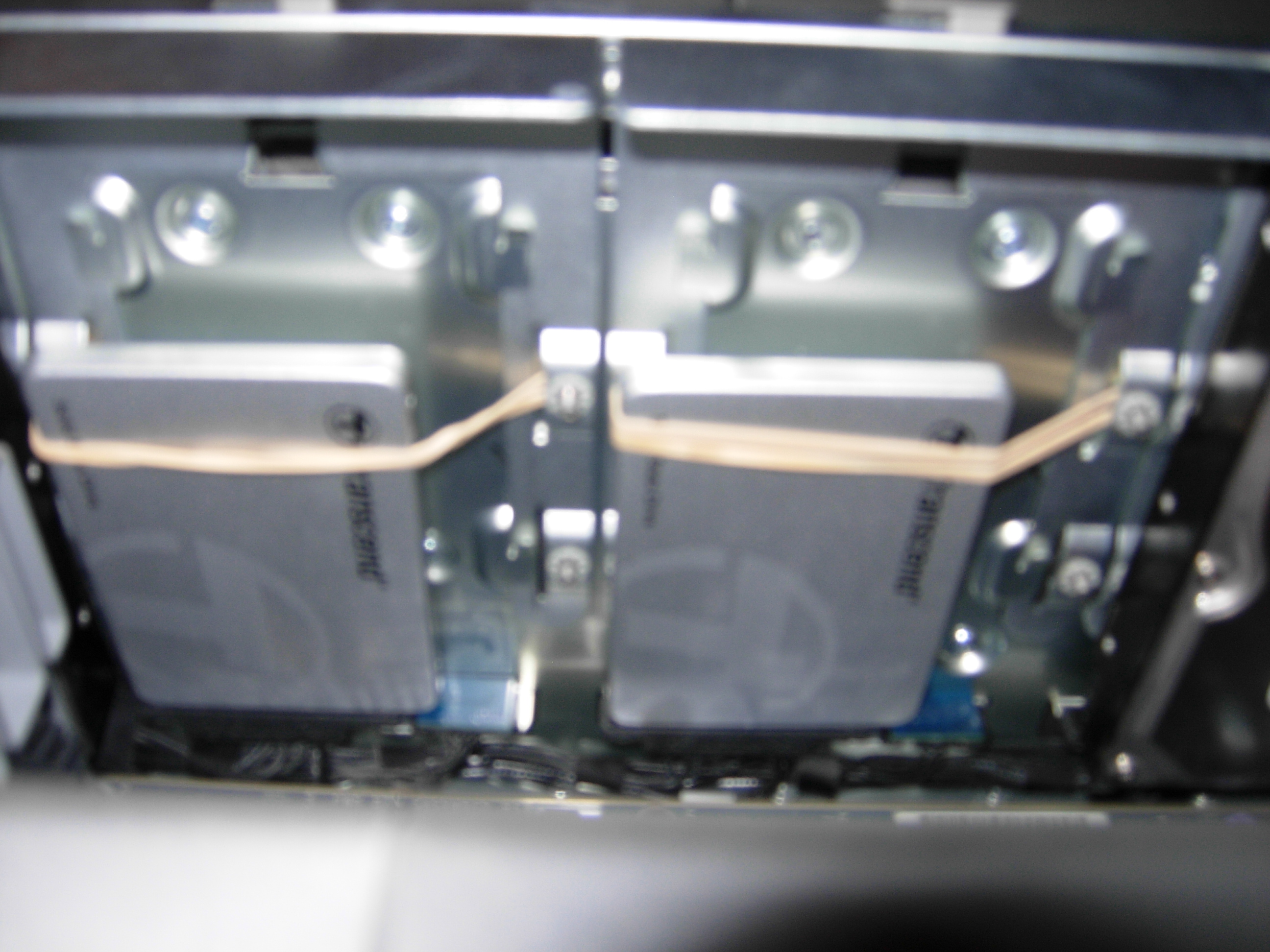

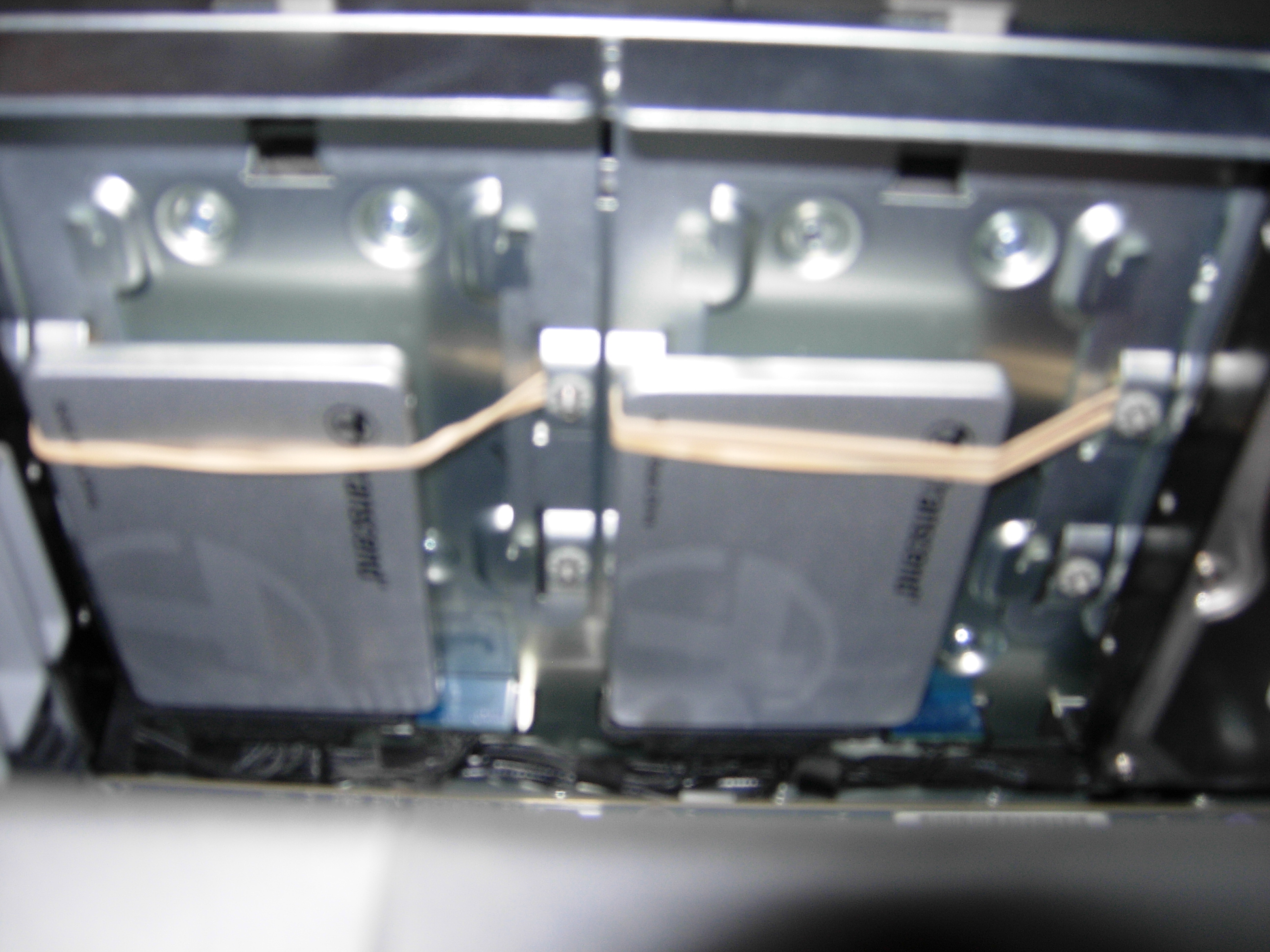

Rubber bands do a decent job of supporting the back ends of your SSD's.
Sorry for the photo quality, or rather lack thereof.

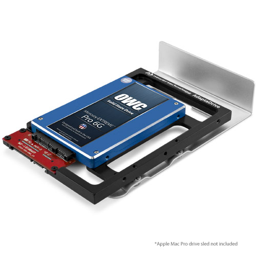

I have one follow-up question: what are some currently available SSD drive adapters that work with the MP 1,1? Most of the solutions I found in these forums are many years old and the links no longer work or the item is no longer for sale.
Here is what I used; it is great, solid, and affordable: NewerTech AdaptaDrive 2.5" to 3.5" Drive Converter Bracket: http://a.co/e8h1RrC
This also seems to be just as good: Sabrent 2.5" SSD & SATA Hard Drive to Desktop 3.5" SATA Bay Converter Mounting Kit (BK-PCBS): http://a.co/dH7ezx3
Nice pic, never tried the rubber bands. I've used gaffer tape, the Newer Adapter and the dedicated OWC trays in 1,1's, 3,1's and 4,1's (now all upgraded via firmware to 5,1). Silver gaffer tape worked brilliantly for years (those OWC trays were something like $40/each at one point!). My Mac Pro didn't get faster when I added the OWC trays. I prefer the OWC trays as there are no electronics or connectors involved. It just a mechanical replacement. Plus you get extra trays for backup 3.5" spinning drives when you add an OWC blue tray. The blue trays also flag that it's probably a boot drive. You can pick up the OWC trays for $10 to $20 these days which is much more enticing than the original pricing.
