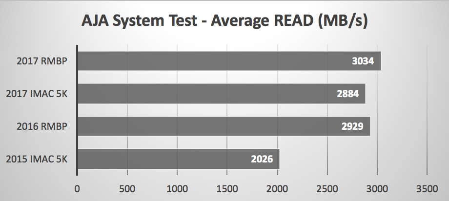

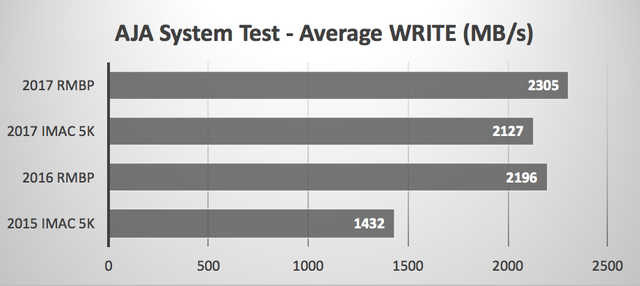

and here some benchmarks for flash storage:
http://barefeats.com/imac2017_storage.html
It's possible the 128 GB flash unit has lower write speeds because a higher write speed doesn't improve fusion drive performance (and is available at lower cost).
