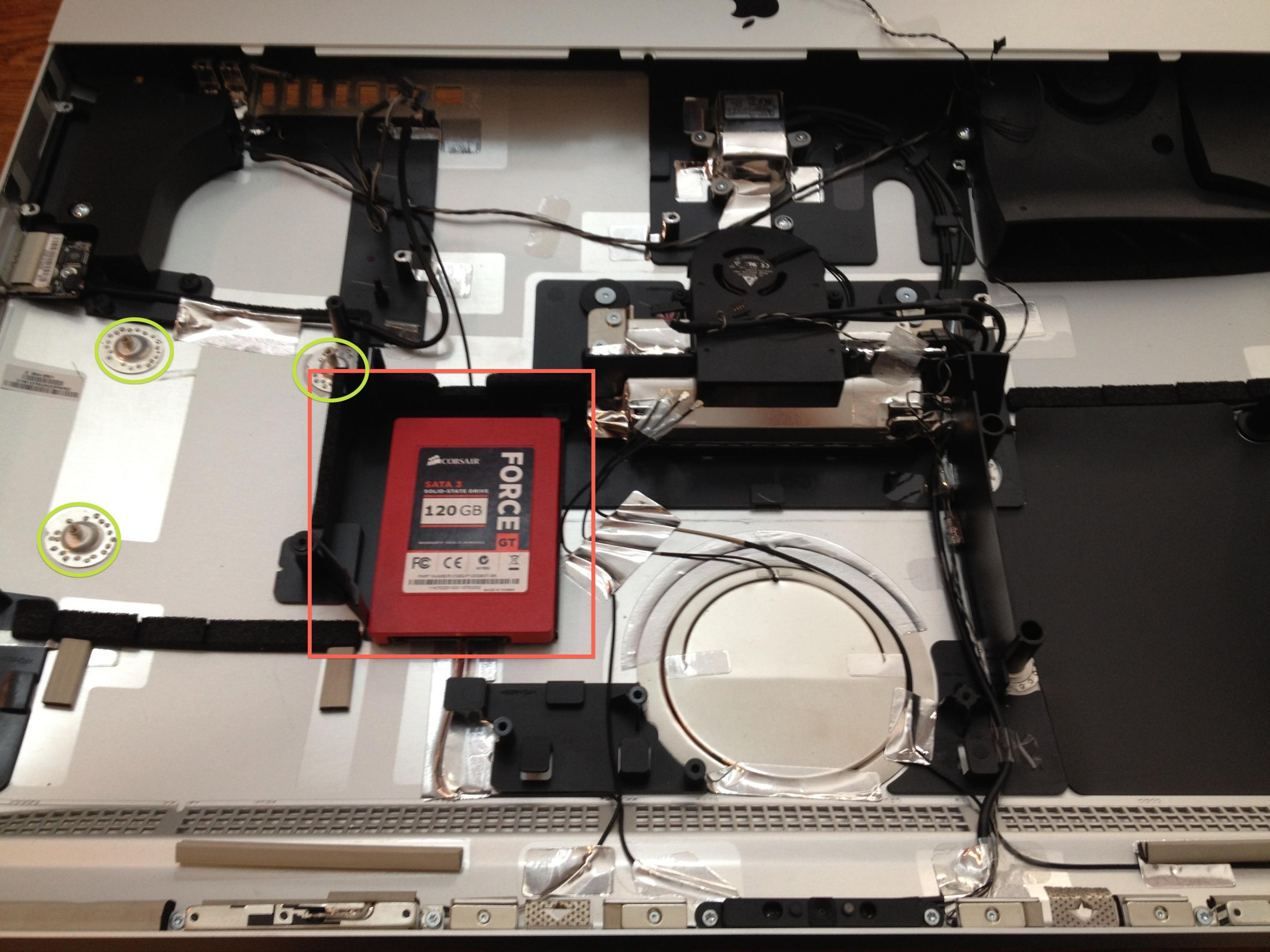

I installed the Corsair ForceGT 120 in mine. Running completely trouble-free since the install. I also switched out the internal 1TB Seagate with a WD 1TB Black that I had lying in a desk drawer.
If you want to do the install proper you need to get the SSD mounting hardware for the iMac as well as the proper SATA+Power cable.
It really is not a difficult task to do, especially if you are only swapping the HDD for the SDD.
Keeping both is a little more in depth but as long as you can follow direction and use a screw driver you can do it.
I'll toss a pic up in a few mins. ***Added***
I purchased the pressure wall SSD mount for a 2010 iMac and it worked w/o any modifications.
The Red square is the 2010 location, while the green circle are where you mount with the 2011 hardware.
I already had the pressure wall mount before I found out about the other mounting hardware which places the SSD directly under the superdrive.
This is the Sata+Power connector I used to connect the SSD to the 3rd factory SATA port. http://www.microsatacables.com/featured/slimline-13-pin-sata-female-to-22-pin-sata-female-cable/
You can use this or you can use a standard SATA cable but you will have to get a SATA Y-connector to pull power from the HDD cable to SSD.

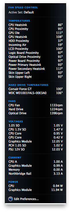

On my 1st SSD install in my 2009 iMac I replaced the HDD entirely with an Intel SSD. On iStats it shows a temp reading but it just reports HDD @ 37deg. Which is way cooler than the ambient temp in the room. This could be a due to a difference between the Logic Boards or the SSD itself reporting because...
In my 2011 iMac, iStats actually shows both drives independently and names them accordingly as you can see in the attached photo.
The only 'problem' per say is that when you replace the stock HDD the HDD fan goes full speed, it even did it with my WD Black drive in its place. So you'll need to get some program that will fake out the sensor to make it believe the stock drive is still there. I suggest SSDFanControl. FWIW I've used it on both of my iMacs and 2 friends and I've yet to notice any problem and the '09 has been going non-stop for the past 2 years.
but again as you can see the '11 picks up the SSD and HDD temps just fine. Hope that helps.
