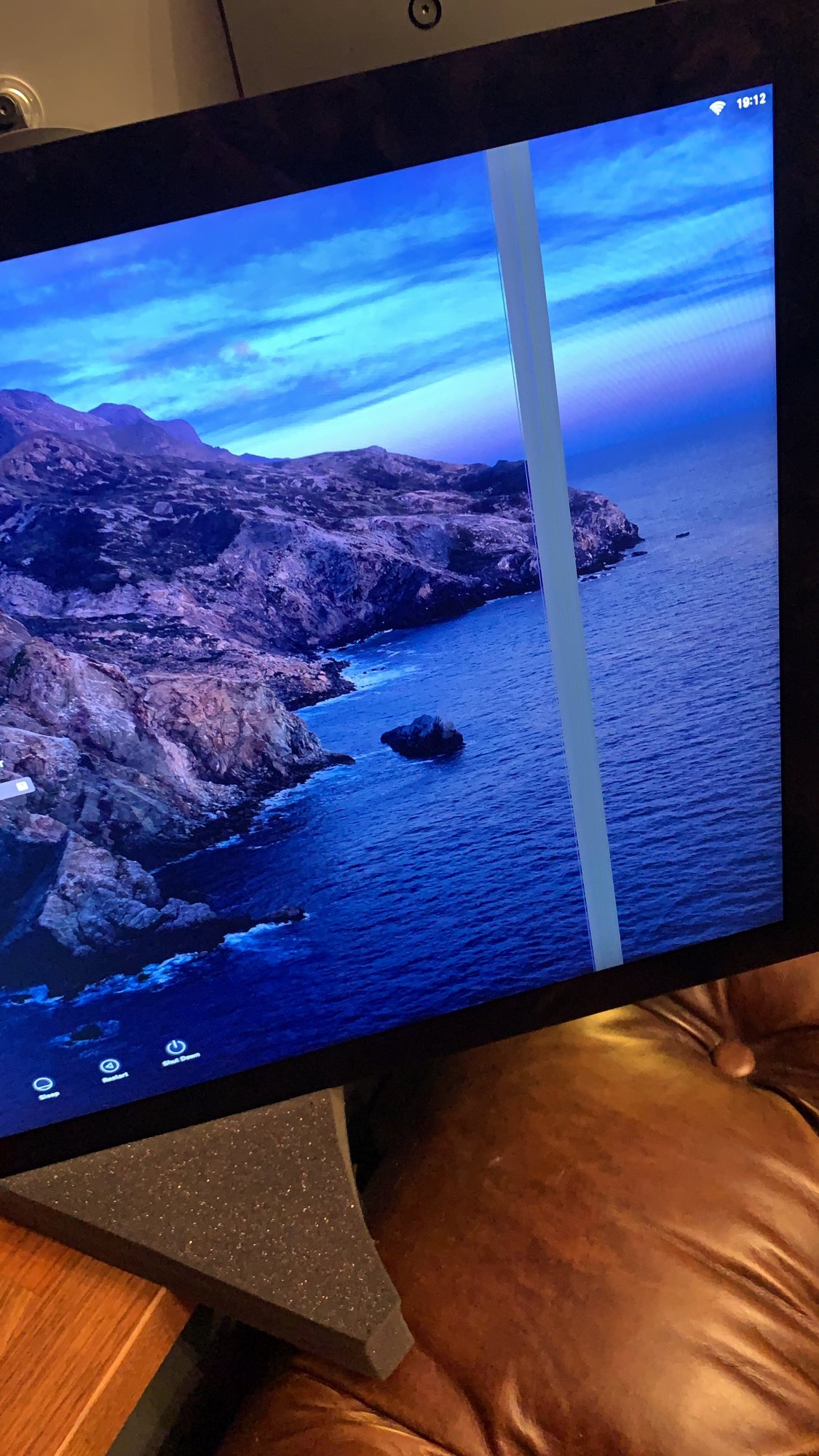

Needless to say this has been a complete disaster. Went to put my screen back on. Went to give it a quick test before sticking everything down and i have destroyed my screen.
Anyone know what has likely cause this? Completely destroyed?
