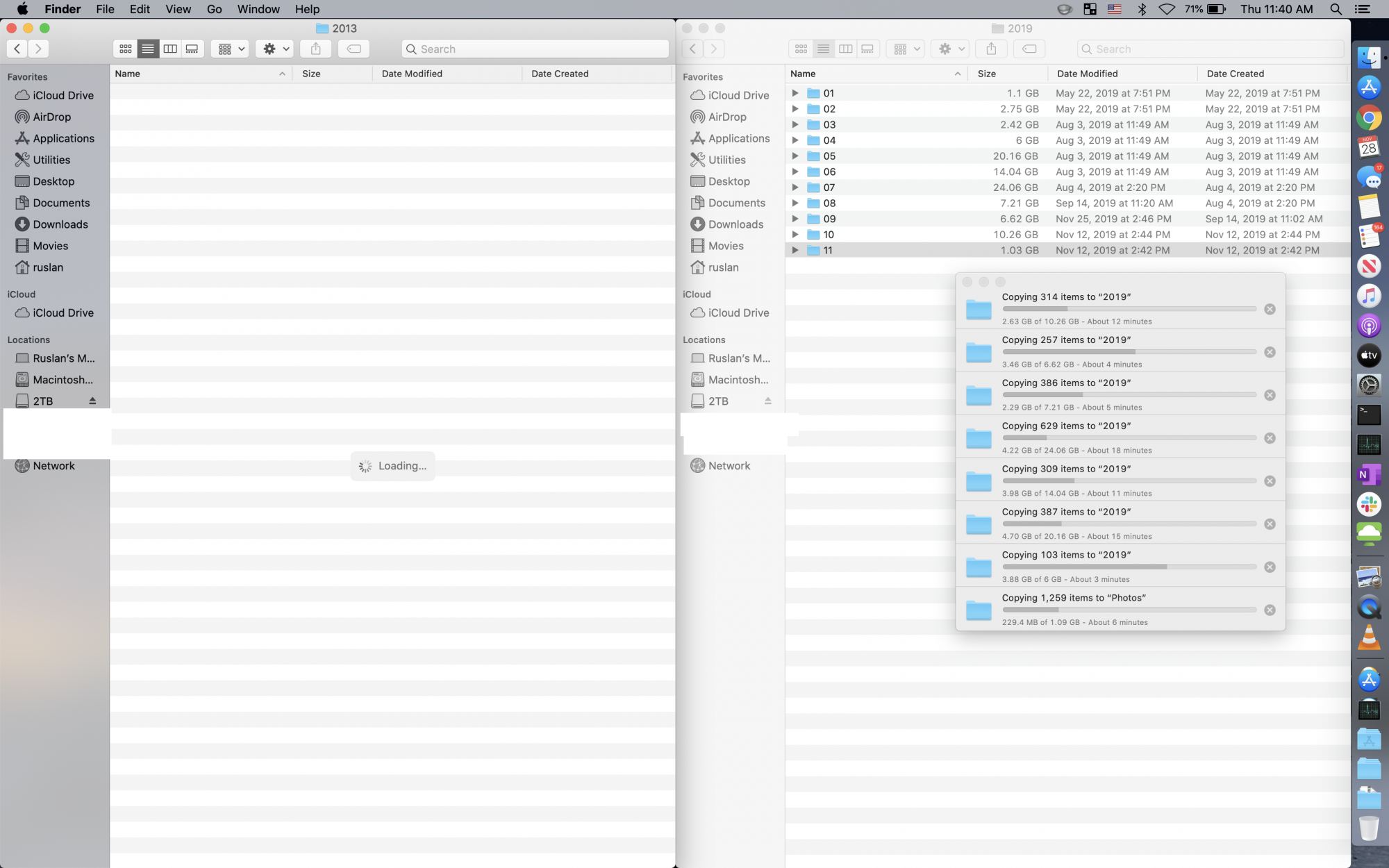

I'm trying to transfer a few hundred GBs from a NAS to a NVMe SSD in a USB C enclosure.
Finder repeatedly hangs after a few GBs (in a Macbook Pro 13", 2019). It just stays on that amount of GBs transferred, no "disk ejected" issues, opening any folders shows the loading text (left).
Tried a different cable, same issues.
Works just fine plugged into a 2019 iMac 5K.
Has anyone seen this before? Any help or advice is appreciated.
Update #1
Looks like a Finder bug. I found a workaround: copying the files first from the NAS to the local SSD, and then from the local SSD to the USB C SSD.
