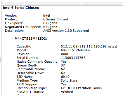

I installed an SSD into my mid 2009 MBP too. How do I know if I'm trim is enabled?
So I just looked at the about my mac page, and went to the s-ata page and looked up the ssd. It listed Trim Support as a yes. I don't know whether it was a no before I used terminal, but hopefully that means it worked.

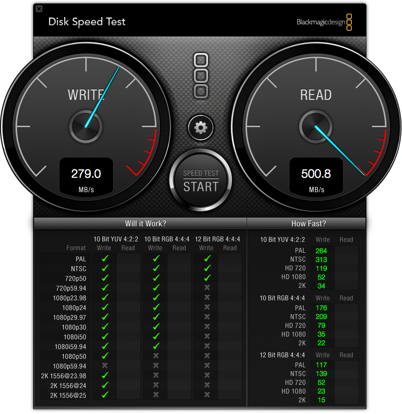

Here is my Cruical M4s performance since I installed it on June 23rd. Still getting the same performance I did since day one with TRIM enabled. I know some drives don't do well with TRIM enabled and a lot of debate around whether you should enable it at all.
