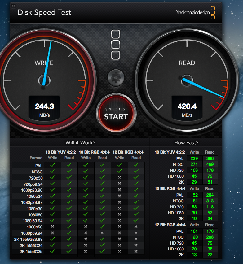

all arrived install and booting off it now.
speed test I just ran
Your test speed is on a Samsung 840 (not pro) in an external caddy right?
Is this caddy a Tunder Bolt or USB 3?
Hi

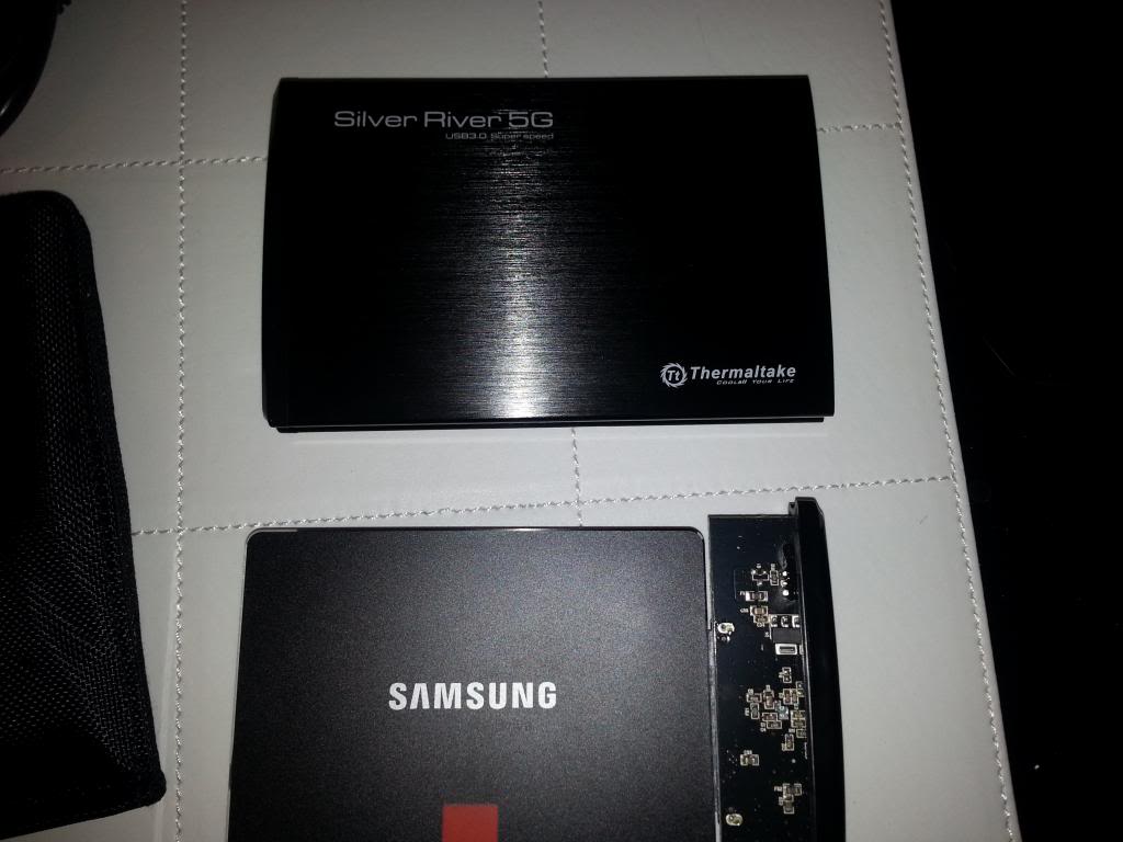

Yes its the 840 not the pro model.
Its in a thermaltake silver river 5g 2.5" USB3.0 case and no extra power cables connected.
