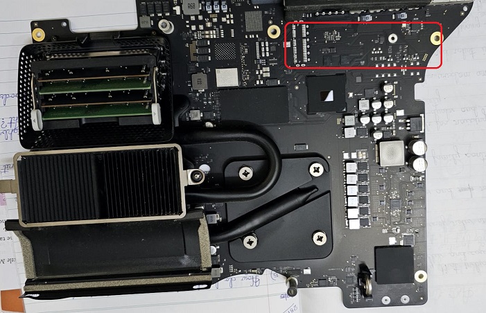

this connector can be used, but it's too complicated for the average person, my conclusion is that it's not worth it! there is usb-c
I think he is asking is it technically possible or not and what to hear your thought. I'm pretty sure he know how to add additional storage to his iMac.
On any new generation Mac, any drives are controlled by T2 chip to increase security if device gets stolen, it could be very complicated if you try to upgrade it with non official firmware.
But there is a chance it may work too, If I can find bad board, I'll try it on 2020 iMac 27" and see if something else needs to be done hardware or software level.
Yes, some caps, resistors, filters might be also required. It's also hard to say that just tracing paths on the board since it's multilayer PCB. Afaik there is no schematics available for latest generation Macs.
I'll update here if when I'm done with my test run.

would love to see if you got around to this as well.
Sad that so many people jumped on the OP for his question, which was clearly over the heads of a lot of people.
the pin pads are there, but it'll be interesting to see if it's possible that the NVMe slot is actually still 'hot' to the PCIe buss.
IF IT IS, that opens a lot of options for a lot of people...
I feel ya. You ask a question and you get a bunch of 'why would you want to do that?' lectures. There's always the people too afraid to mod their own computer and they want you to be a wuss and afraid too.
For all they know, I have no problem financially buying two iMacs with the idea of using one to experiment on. So I wish they'd just answer the question or shut the f up.
In answer to your question, from what I can tell it doesn't look promising https://appleinsider.com/articles/2...eardown-shows-lack-of-storage-upgrade-options
This in why I personally bought two 2019 imacs. In both of them I (fairly easily) swapped out the spinning portion of the fusion drive with a 4tb samsung 860 evo ssd.
That’s why I got the 2019, plus it’s the last 32bit capable Mac. I’m planning to swap out the SSD as well.
Looks like you nailed it judging from today’s post regarding the Nvme adapter kit 🎉
iMac 2020 27 inch EMC 3442 was non upgradable soldered on board.
