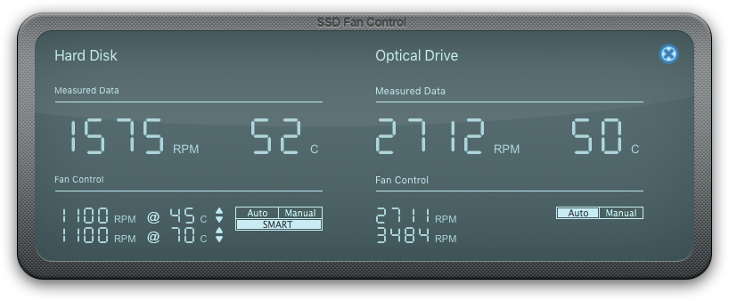

Temps are a lot lower, with intensive use (hours of gaming) about 20 degrees celsius lower. Highest temps are now 65-67 degrees celsius instead of 85. Fan noise is a lot less. Sometimes you hear the hd spinning up for a few seconds, which is the loudest component. A traditional hd really consumes a lot of power (30 W) and generates a lot of heat. A ssd a fraction of that and doesn't generate heat. Also, my iMac now flies!!

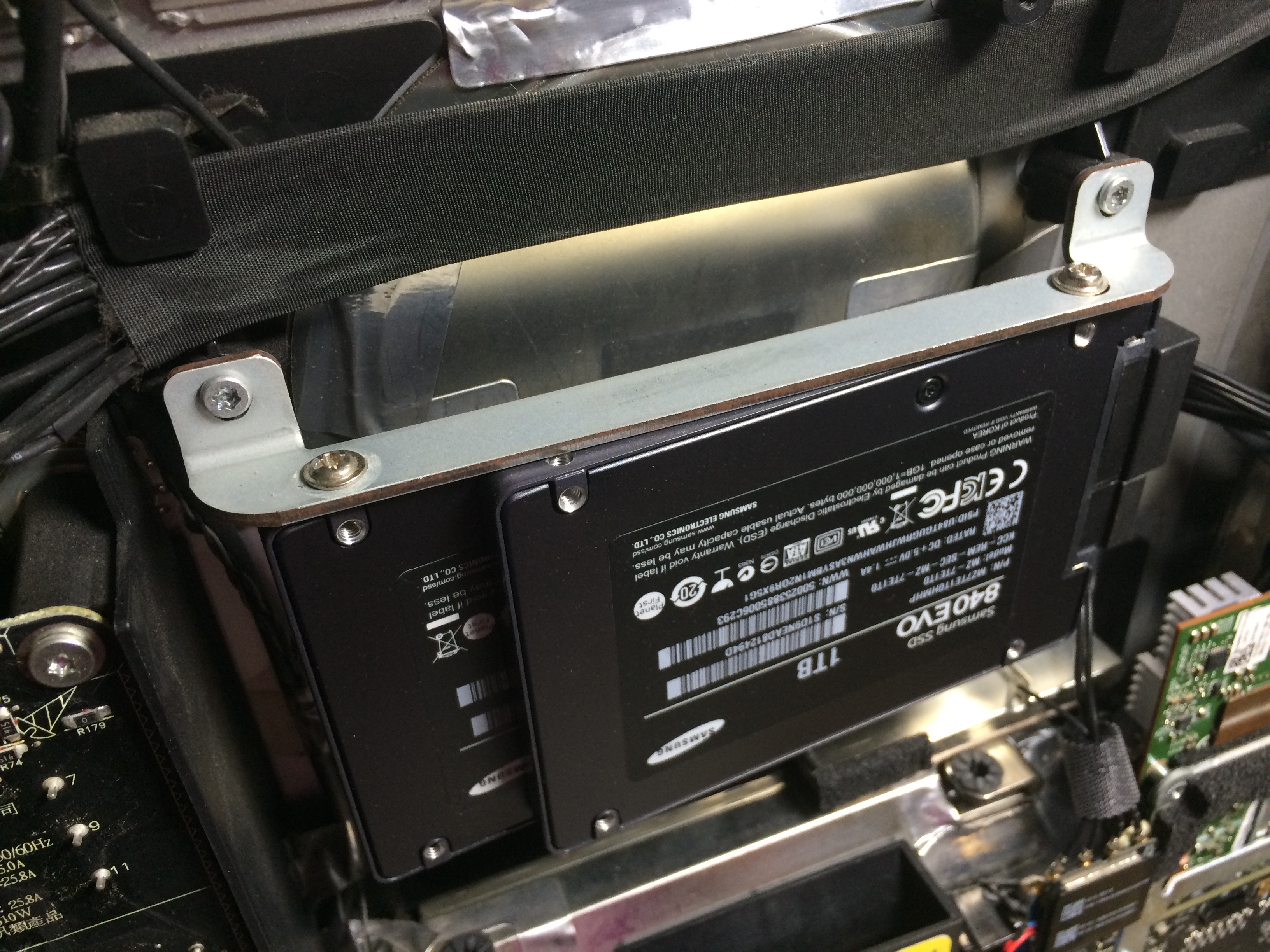

I put both my SSDs (1TB Samsung 840EVO) on the main storage bay in RAID0 setup (total 2TB) in order to have smooth air flow behind the OpticalDrive.
