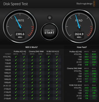

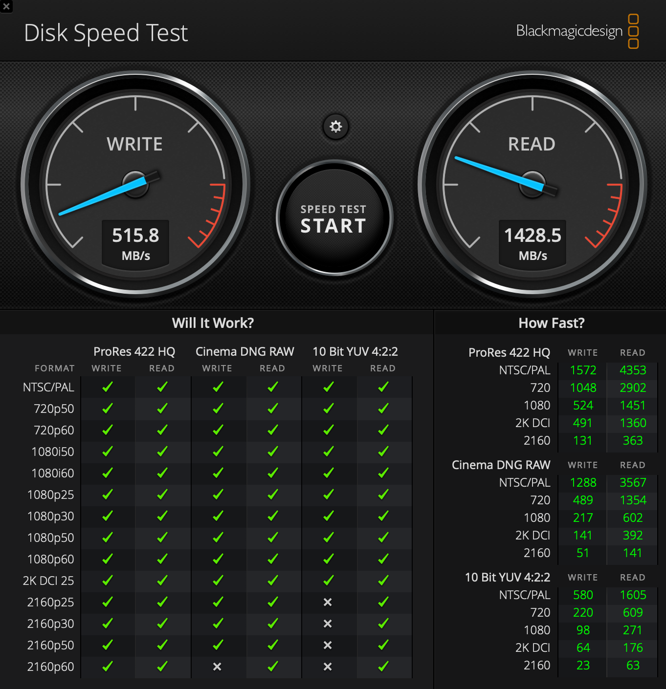

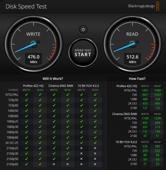

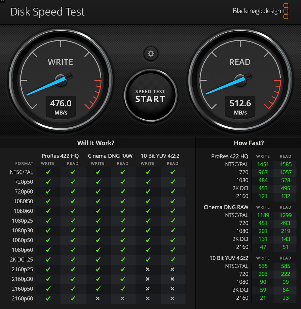

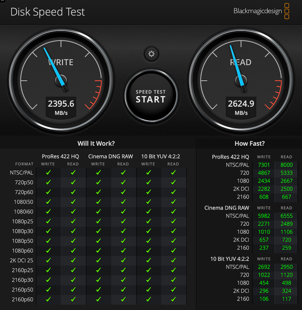

Background: Just installed a PCIe NVMe SSD and a SATA SSD (2017 iMac 27)
USB-C (TB3) and a very good external SSD (SanDisk, Lacie...) should give you R/W in the 300/350MB/s range. Not quite 5x in speed, but close.
Therefore, if it's sufficient for your needs, then I would go with that as it's the easiest. And you can always decide for internal drives after testing it.
I'm posting my Blackmagic R/W values for you to compare. However, opening the damn thing and installing the drives is not trivial. In particular the NVME M2 drive. That being said, it's worth the effort. In my case, video editing is noticeably improved and faster.
Good luck.
