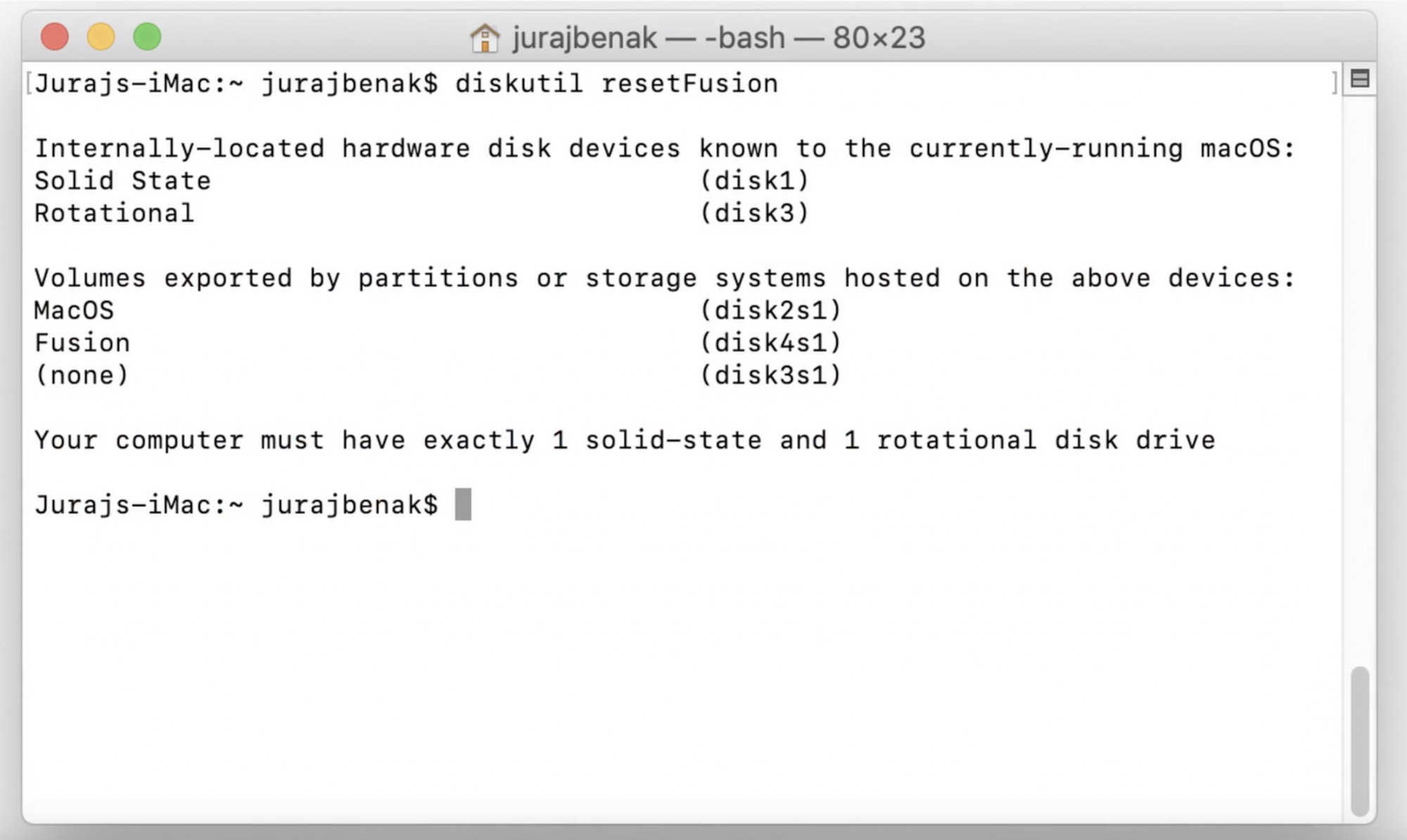

I was watching this video and don't know exactly what it means...?

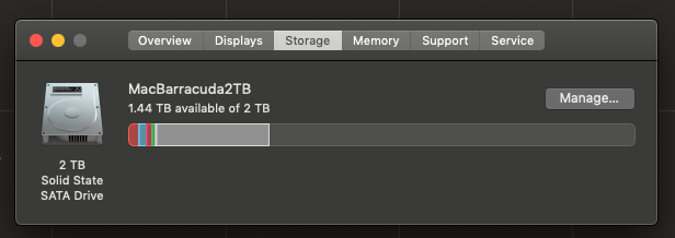

Done!....that was easy...🙂
the hardest part, other than using a couple guitar picks to open it up (and it wasn't too hard really) was figuring out how those damn display cables are connected to the motherboard....
I didn't want to break anything and couldn't figure out exactly how they disconnected...took almost as long to do that as it did to peel open the case.
I already created a new backup from the SSD image in Time Machine....Piece of cake! 🙂
