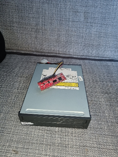

Starting to get the bits and pieces in, one by one...
Working IDE dvd (a nec, hopefully it'll get accepted by the iMac) and the Marvel based red pcb sata to ide adapter...
Still waiting on the ram, after that, ready to go!

  • Replaced the faulty DVD with a second hand (9€) NEC pata drive. Works perfectly.
  • Replaced the hard drive with a 120 GB sata SSD (cheapest decent brand I could find, 19€ Apacer, actual speed doesn't matter much with the 66Mb/s ide bus), through a Marvel chipset Sata to PATA adaper (the red PCB thingy).

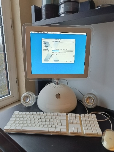

And heck, for being als old and as small as those little transparant ball "pro speakers" are, they do sound pretty good!
After I installed Tiger, on first boot you get that intro with some fancy graphics and music, back in those days, that must have really been a kicker!

Now doing a fully automatic, over the internet, update from 10.4.6 to 10.4.11

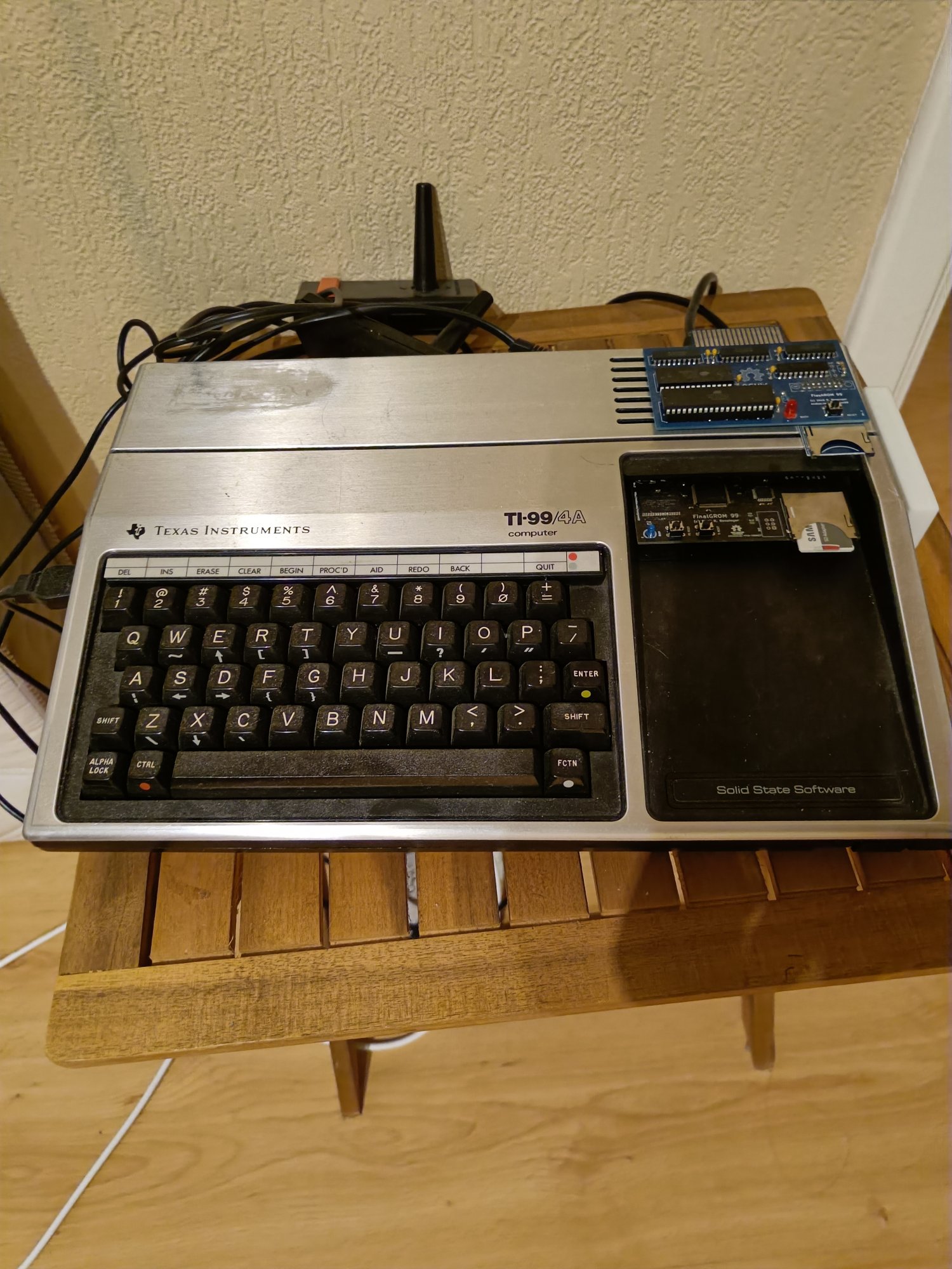

As a little hint (and totally off-topic), in the pic my very first computer, given to me by my parents (bless them, has pretty much set my carreer path with that gift).
In my possesion for a tad over 40 years, an hope to be able to leave it in working condition to one of my kids when I get too old to realize what the thing is 😛
