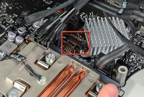

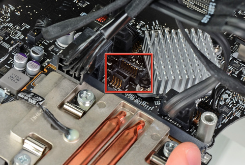

I won't be replacing anything. There are additional ports on the logic board (one for power, one for data).

Does anyone know what speed this supports?

Done it before. Just get the 6GB SATA3 data cable and the right SATA power cable.
Follow iFixit guide.
https://www.ifixit.com/Guide/Installing+iMac+Intel+27-Inch+EMC+2429+Dual+Hard+Drive+Kit/7575
You will get SATA3 speed.
