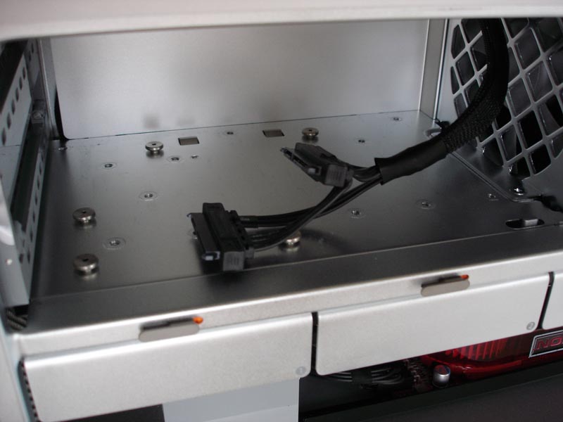

This is what your ODD bay connectors look like. So yes, you can do it exactly as you described.
