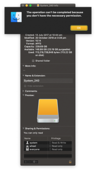

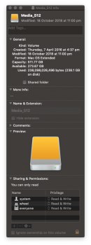

I have two PCIe SSD's in my cMP - a boot drive (OWC Accelsior, slot 2) and a media drive (SM951, slot 4).
I installed Mojave about a week ago - everything has been fine until now.
I restarted the machine yesterday and shortly afterwards found that the project I was working on couldn't be saved to the media drive.

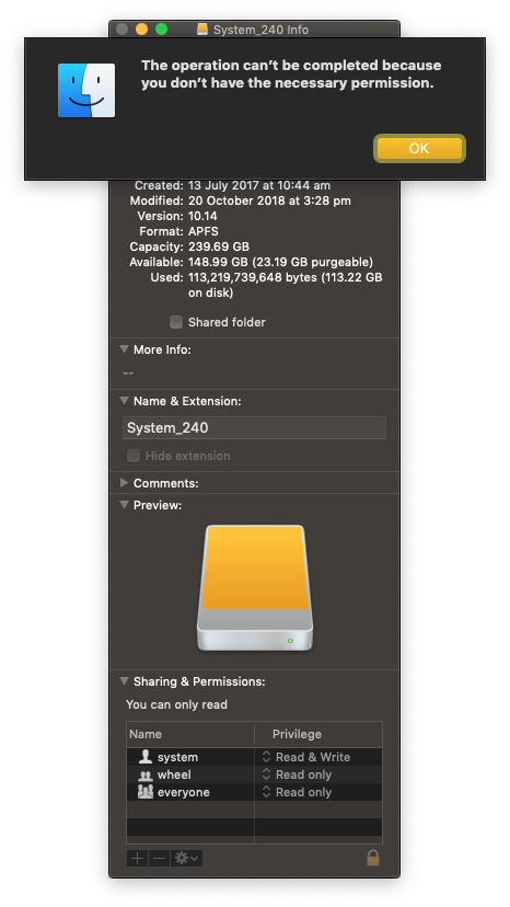

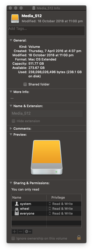

Checked permissions on both drives and found that they're both now read only.
Please see the attached pics: Media drive says it's read only but the three owners are all set to read and write. System drive says it's read only but the owners are a mix of read and write and read only. When I try to change permissions it tells me I don't have permission! I'm set up as an administrator.
I can choose to ignore ownership on the media drive but it makes no difference.
All pretty confusing - does anybody recognise this or know a fix? Is it a Mojave bug?
Thanks.

Yep, separate lanes - OWC drive is slot 2 (boot drive) and the SM951 (media drive) is on a Lycom DT120 in slot 4. I've also read the horror stories re OWC but I've not experienced them myself - it's always performed ok for me though I am looking forward to getting an NVMe SSD to replace it.
Although both drives say read only I can still write to the system drive ok. I can't write to the media drive. I was hoping there might be a fix before resorting to a drive restore but I may try that anyway.
[doublepost=1540058593][/doublepost]Ok so I tried selecting 'ignore ownership on this volume' on the SM951 media drive. I restarted and now everything is working normally again. Feels pretty bug-like to me.

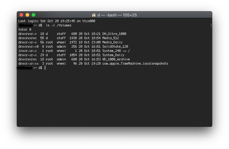

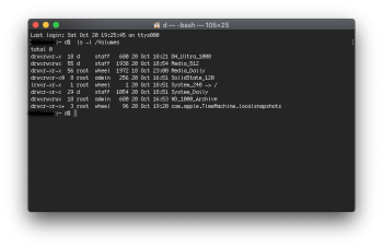

Don't worry. It's safe to run it. That command lists details about every drive on your system (/Volumes is the directory where that info is stored). Edit: and you're smart to be skeptical. Always good to know what exactly a command is supposed to do before you run it! :)
Cheers, it shows this:
