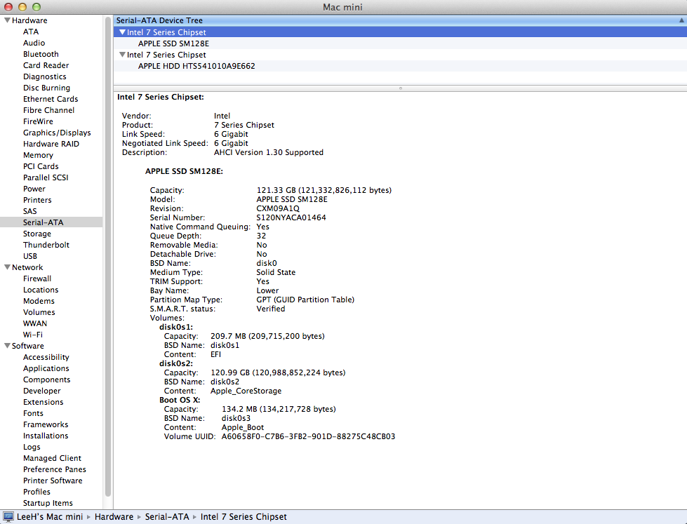

You can think of it as follows: Apple's SSD driver does not use TRIM command on any other SSD than their own. What TRIM enabler does, is just override the drive identification code in said driver, so it will validate all drives as Apple's.
In more detail, there is a string
APPLE SSD
in the driver code that simply gets overwritten with zeroes.
All Apple SSDs have this APPLE SSD as part of their name in identification string:
Apparently the hack simply makes any drive name match so TRIM gets used on the drive.
