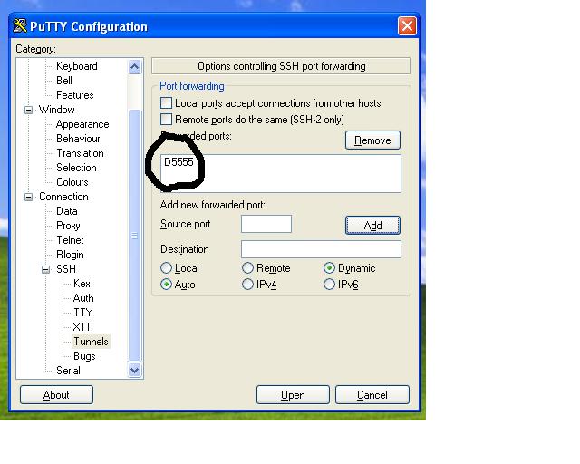

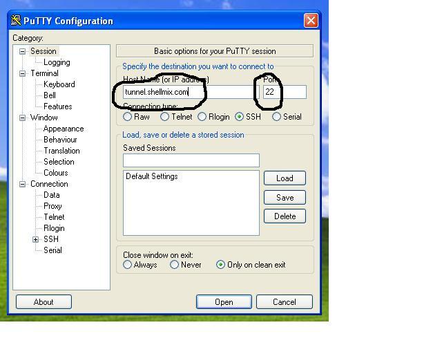

I really appreciate the support but I'm still not very clear about the command.

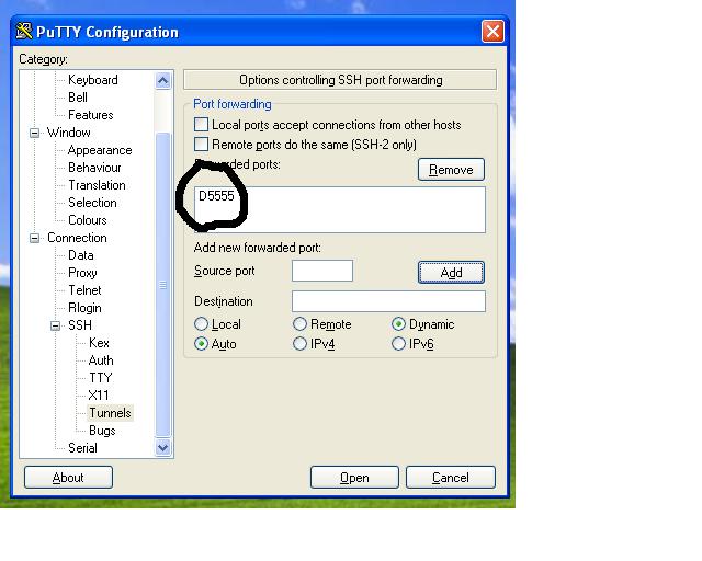

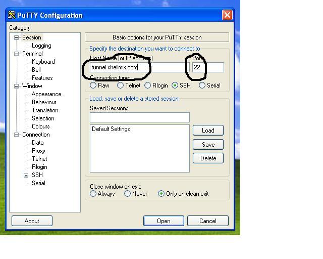

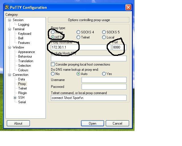

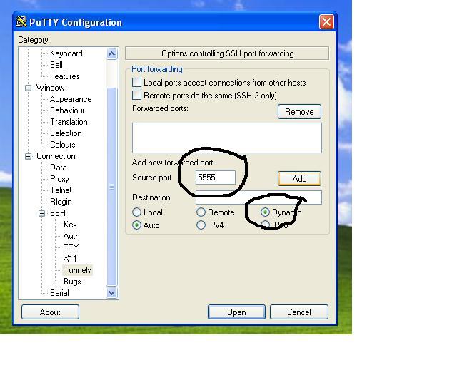

See I'll tell you what exactly I entered in the PuTTY for bypassing.
Please tell me what command do I use in the terminal window.
Thanks again.

So it's like I said :
Code:
-D 5555
It's right there in the man page :
-D [bind_address:]port
Specifies a local ``dynamic'' application-level port forwarding. This works by allocating a socket to listen to port on the local side, option-
ally bound to the specified bind_address. Whenever a connection is made to this port, the connection is forwarded over the secure channel, and
the application protocol is then used to determine where to connect to from the remote machine. Currently the SOCKS4 and SOCKS5 protocols are
supported, and ssh will act as a SOCKS server. Only root can forward privileged ports. Dynamic port forwardings can also be specified in the
configuration file.
What I understood from your previous two posts is the command below:
ssh -D 5555 -L 5555:172.30.1.1:8080 user@host.com
Does it mean that it will bypass my proxy of 172.30.1.1 at port 8080 to SOCKS 5 at port 5555, because if it does then it doesn't really work. I get an error, operation timed out.
Please correct me.
Thanks a ton for the posts. BOWS.
You didn't quite read my posts there. You can't use both -L and -D at the same time on the same local port (5555). And your -L arguments do the opposite of what you want.
Again, read this sentence carefully, it should answer your question :
Since you haven't provided any information on how you want to make your SOCKS proxy, just know that the command line options you want are -L, -R or -D depending on the type of tunnel you want to make. These should be exactly like PuTTY's in their syntax.
So going by your screenshot, you want -D 5555. That's it.
Code:
ssh -D 5555 user@host.com
That will do exactly the same thing as your PuTTY does.
