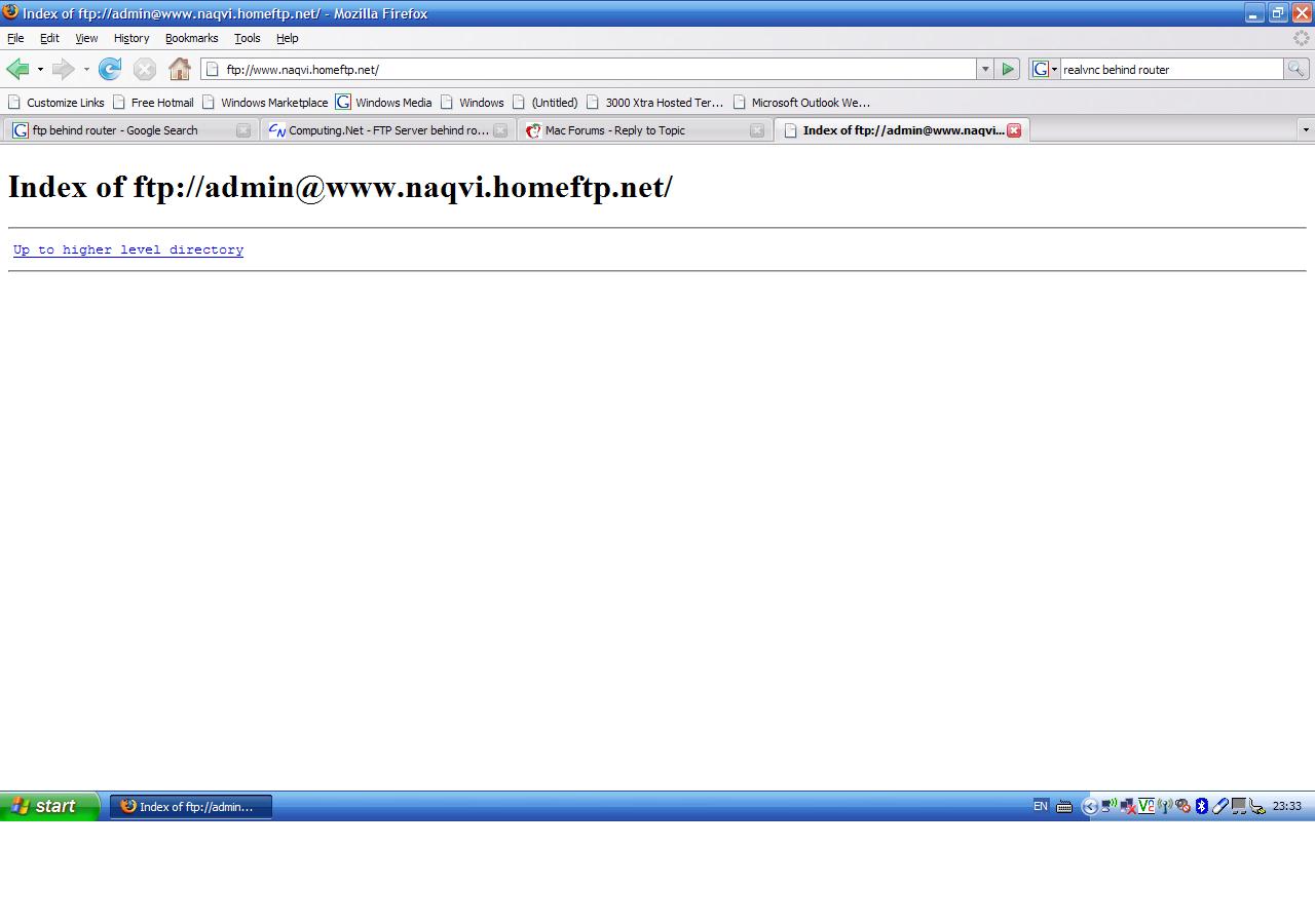

Ok folks I am trying to setup and FTP at home. It works on my LAN but how can I make it work from WAN? Should my FTP client try access the WAN IP? And I am behind a router so the thing gets split up onto the LAN. Now I went to my router config and forwarded (or something) FTP port 21 onto my server computers LAN IP. Is this correct?
I am trying to setup a Windows XP as the server. Should I use Passive or Active mode?
OK when I try to use another computer on the LAN to access the FTP via WAN, it gives me a 530 error Invalid User. What should I do. I ahve configured my FTP server to allow anonymous access.

Latest update:
I tried accessing the FTP from another computer via WAN. I had to put in my routers admin password for it to stop showing me the error 530 invalid user. But once I do that, nothing comes up as though I am in an empty folder (I am accessing using Win XP Home). But when I use the same PC to access the FTP via LAN, it works properly.
An idea as to whats going on?

Ok this is what I did:
Made a DynDNS account.
Configured my router to update my DynDNS account with the latest WAN IP address
Forwarded port 21 to my static LAN IP address running the FTP server
Configured my FTP server.
Successfully used an FTP client connected to the server via LAN using anonymous user
tried accessing the DYNDNS host name using HTTP and got to my router's browser based configuration page (lol)
i typed in ftp:// then my DynDNS hostname says invalid user.
I tried putting user name as admin which is my routers administrator username
it asked for password, i put in the routers password
this is what I get (attached screenshot).
it looks like there is nothing.
I am using NAPT as my address translation. NAPT is Network Access Port Translation. If I put NAT, only one computer can access the internet.
Is somethi9ng wrong with my DynDNS? I can show u a screenshot.

For starters, FTP is incredibly insecure. All usernames and password are sent in cleartext. But since you're using it, make sure you chroot people into their own accounts.
In order to make this work, you have to open up the requisite ports on your router and point them to your Mac. Ports 20 and 21 need to be opened and clients need to use active FTP.

Opening/Forwarding port 20 did not help. The point over ehrer is that my FTP server is fine and all that. Problem over here is I think because I am behind a router and my computers IP is hidden or inaccessible from the WAN.
Your Router must have ports 20 & 21 open and port forwarded to your machine that is hosting the FTP server. And then, the clients MUST use active FTP to connect. Passive won't work. Most FTP clients use passive by default.
Use netstat -n to ensure that your ftp service is functional. Make sure your software firewall is off as well.
Read this link, it's a nice summary of active vs. passive ftp, which as yellow stated is why it's not working for you.
http://slacksite.com/other/ftp.html
EDIT: Should also note, a far better solution would be SecureFTP (SFTP), which would solve a lot of your problems by only needing to forward port 22, not to mention being a lot more secure. Just set up a guest account and give all your friends the username and password. Much simpler from the port-forwarding perspective and more secure...
