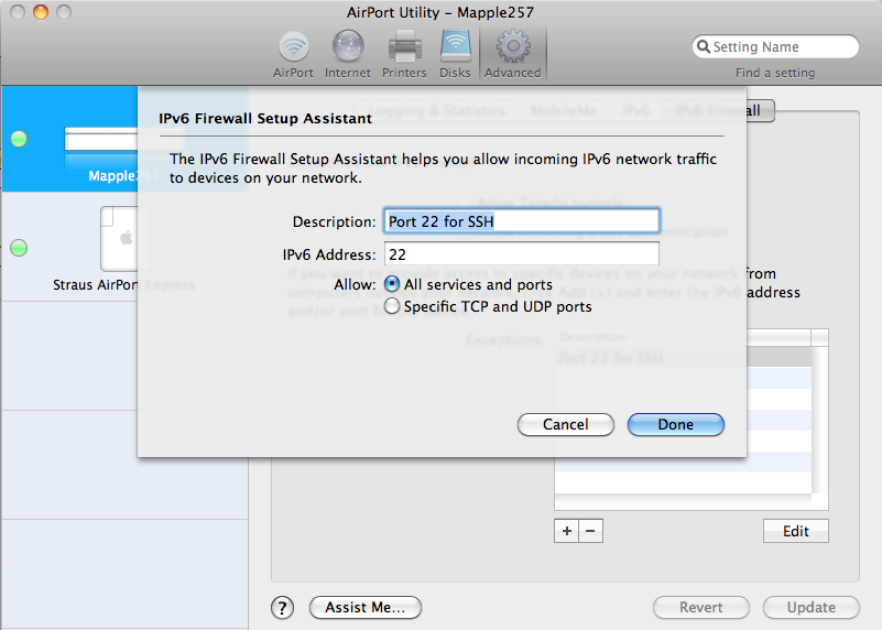

On the Airport Extreme, I tried opening port 22 but I am not sure if I did it right, I will post a screen shot.

You will need to configure your Verizon router to port forward incoming ssh connections to your Mac.
When it's successful the shields up will report tcp 22 as open.

Maybe you can post a screenshot if still stuck. Make sure you don't post anything that can identify you in your screenshot. e.g. username, ip address, etc
