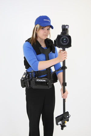

Stedicams and glidecams require a great deal of skill to get good results there is also a Uk manufacturer that offers cost effective if a little home made devices as seen here however they can become very tiring after even a small period of use.

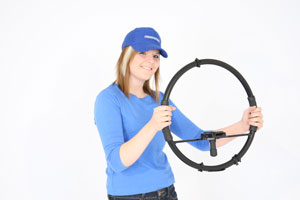

I would highly recommend what may look like a strange device however the FIG rig designed to be used in movies many years ago has a massive following and once used is hard to put down, the fig rig will allow you to use both hands to hold the camera, offers a smoothing effect to hand held work and allows you to attach lights mics etc so you have a compact all in one solution, the fig rig is also easy to clean as you can see here it is a simple circular ring.

Tell them Camerent sent you along I am sure they will look after you here is our fig rig in action and also the stedicam🙂 you can see the fig rig is a lot easier to use and keep clean not sure what happened to the camera in the fig rig pics.
If you want to have a play with either one just let me know
All the best Camerent

I think somebody forgot to stick it on the quick release 😉
I've been trawling the 'net and the Fig Rig is looking increasingly like an excellent choice - reasonable price, expandable system and as you said, easy to wipe down and keep fairly sterile.
If we need a play I'll get back to you - we may just spring for one without trying beforehand!
I wouldn't get the Fig Rig.
It's designed for camcorder systems which have remotely operated controls (a lot of the pro camcorders have the ability to move focus/zoom to the end of a wire, which you can then fix to the rig and still operate when you're holding the hoop).
Just think about it - with the fig rig, you have to hold the hoop with both hands, and you're unable to adjust anything on the DSLR! Not good.
You need to think about 'points of contact' when you're stabilising these things - as the more points of contact you have (and the wider these are separated) the less freedom the camera has to move. The fig rig works well, as it moves the points of contact far apart - and this cuts down on the amplitude of movement.
Take a look at the Zacuto website. Their Z-finder is amazing on the new video DSLRs - and coupled with a gunstock, you get 4 points of contact (eye on eyepiece, shoulder on stock, both hands on the body).
